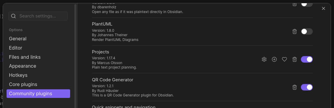

That’s strange indeed. Could you do a screendump of Settings > Community Plugins, like in the following screen dump:
And copy in the info from Show debug info, or at least from the About Obsidian screen?

Hmmm, I wrote a long reply which perhaps I forgot to hit reply because I see no evidence of it. Suffice it to say, by looking at the developer console log (who knew there was such a thing) I saw the error message: Uncaught (in promise) Error: No input text, from which I concluded that the plugin was indeed executing and thought it had no input. Accidentally, I hit return on my sample code so that the URL was on the line following the command and voila!, the QR code appeared. And, for example, when I copied your sample invocation (instead of mimicking it exactly), all the text was on 1 line so it failed as the qrcode plugin (Idon’t know about all plugin input) expected the input on the line following the command. Anyway, though am far from knowing the full story, I am at least able to generate QR codes. Thanks for all the help.
