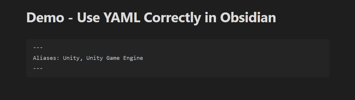

Not sure if the above images have come out correctly but that’s what I’m trying to mimic, to have that table at the top of my documents. (I don’t have a screenshot of their screen as it’s a YouTube video, sorry.)
I’m on a PC, not using any plugins or anything like that - it’s essentially a fresh install.
What I’m doing down below.
For more clarity, sorry. Doubled up on an above screenshot.
Is this set of instructions for a Mac-based version of Obsidian? Mine instructions aren’t showing what you’re providing, sorry.
The start of you note should look exactly like the block below:
Aliases: Unity, Unity Game Engine
You’re not supposed to have the triple backticks at the head of the file. That will produce a code block, like the one above here. It’s also important that there is nothing else before the first line of ---.
In addition you might need to verify that showing of the frontmatter is enabled, see Settings > Editor > Show frontmatter, and enable if disabled.
