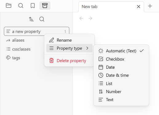

Open the All properties tab, right click your property, hover Property type, and select the type you want:
