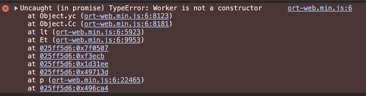

I have been searching on the internet and found some old plugins that was able to use Web Workers. But when I tried to run it myself, I got error of Worker is not a constructor.

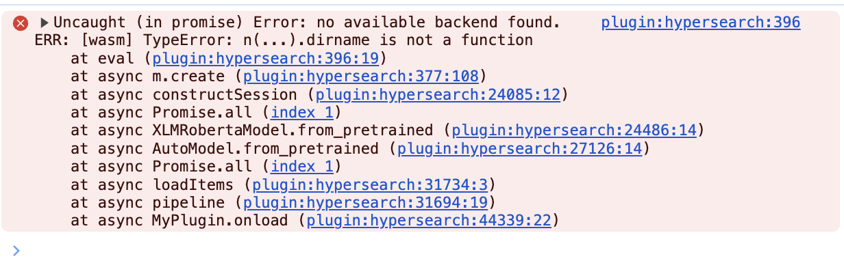

@joethei Hey Johannes, I have put together a branch that has loading issue with wasm. Here is the code:
Error message I am getting:
This might not have anything to do with web worker, but I don’t have a way to verify because bundled code is obfuscated. Will continue to investigate.
@joethei I finally arrived in the Worker is not a constructor error. Using Webpack to build this time (pnpm webpack in the project) and it gives me the following error:

@lhr0909 maybe this issue can help, at least with your first error message.
