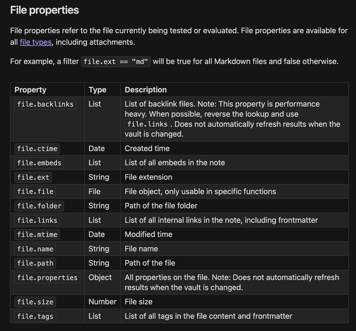

In theory you could use .replace(⋯) to manipulate file names with certain patterns although in Obsidian we cannot assign custom properties to arbitrary files (only to md or note files). However the thing is that these arbitrary files have implicit properties which could be used in formulas:
https://help.obsidian.md/bases/syntax#File%20properties
There are plugins like Binary File Manager that automatically convert arbitrary files to note files (or md files) which can then feature custom properties. The problem is that sometimes implicit properties are enough so Binary File Manager’s automatic conversion is not always needed. Hence you could somehow toggle the plugin into use when you want to make such conversions.
