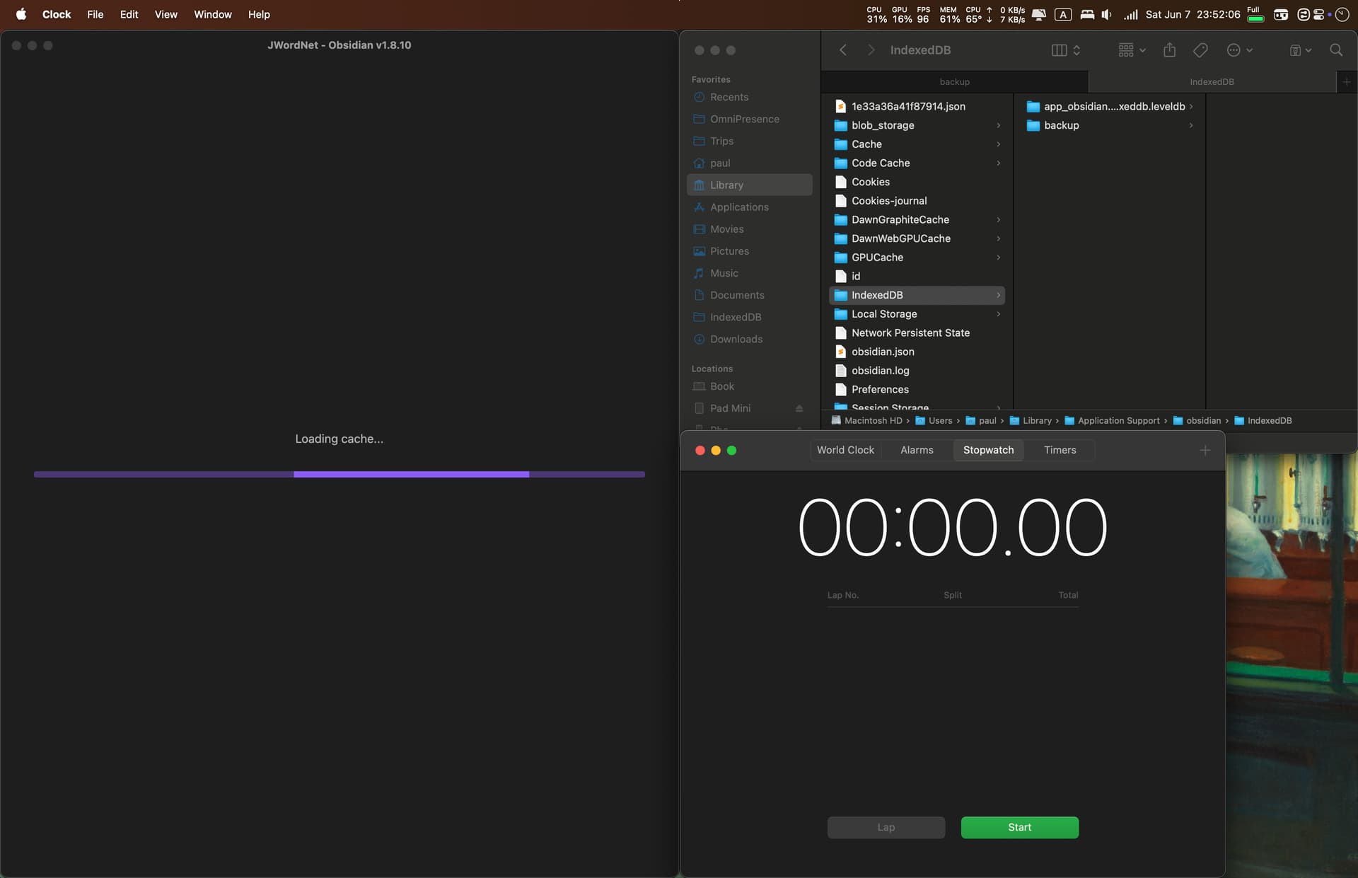

Find your IndexedDB folder
Mac: /Users/Your Username/Library/Application Support/obsidian/IndexedDB
Step 4: Make a new folder with any name. Mine is “backup”.
Step 5: Open your vault.
Step 6: Put the “app_obsidian.md_0.indexeddb.leveldb” folder inside of “backup” folder. This will make obsidian skip “loading cache…” screen.
Step 7: Quickly put the “app_obsidian.md_0.indexeddb.leveldb” back into the “IndexedDB” folder.

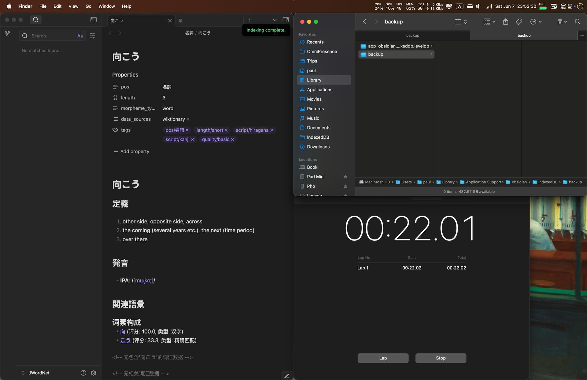

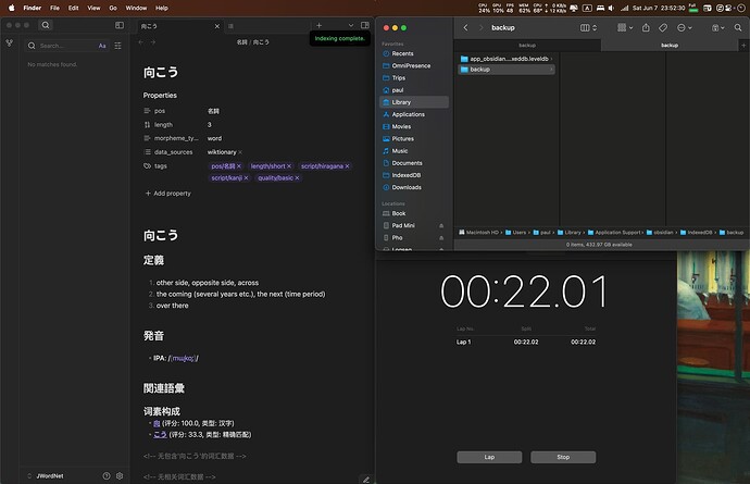

----SUCCESS----
Comparison:
VS
Context
I have 150k md files of around 5kb each for a japanese vocabulary network for personal use. The loading cache has always been an issue where I needed to delete the IndexedDB folder to enter the vault and would have to reindex for 5+ minutes to begin usage. So I thought why not try to cheat the system by skipping loading cache then putting index files back to reduce the index time, which works wonderfully.
