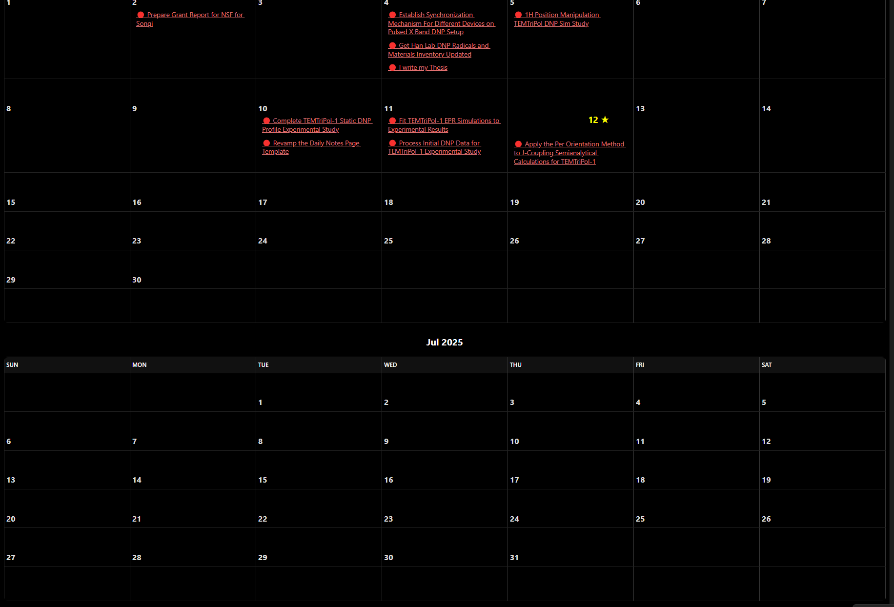

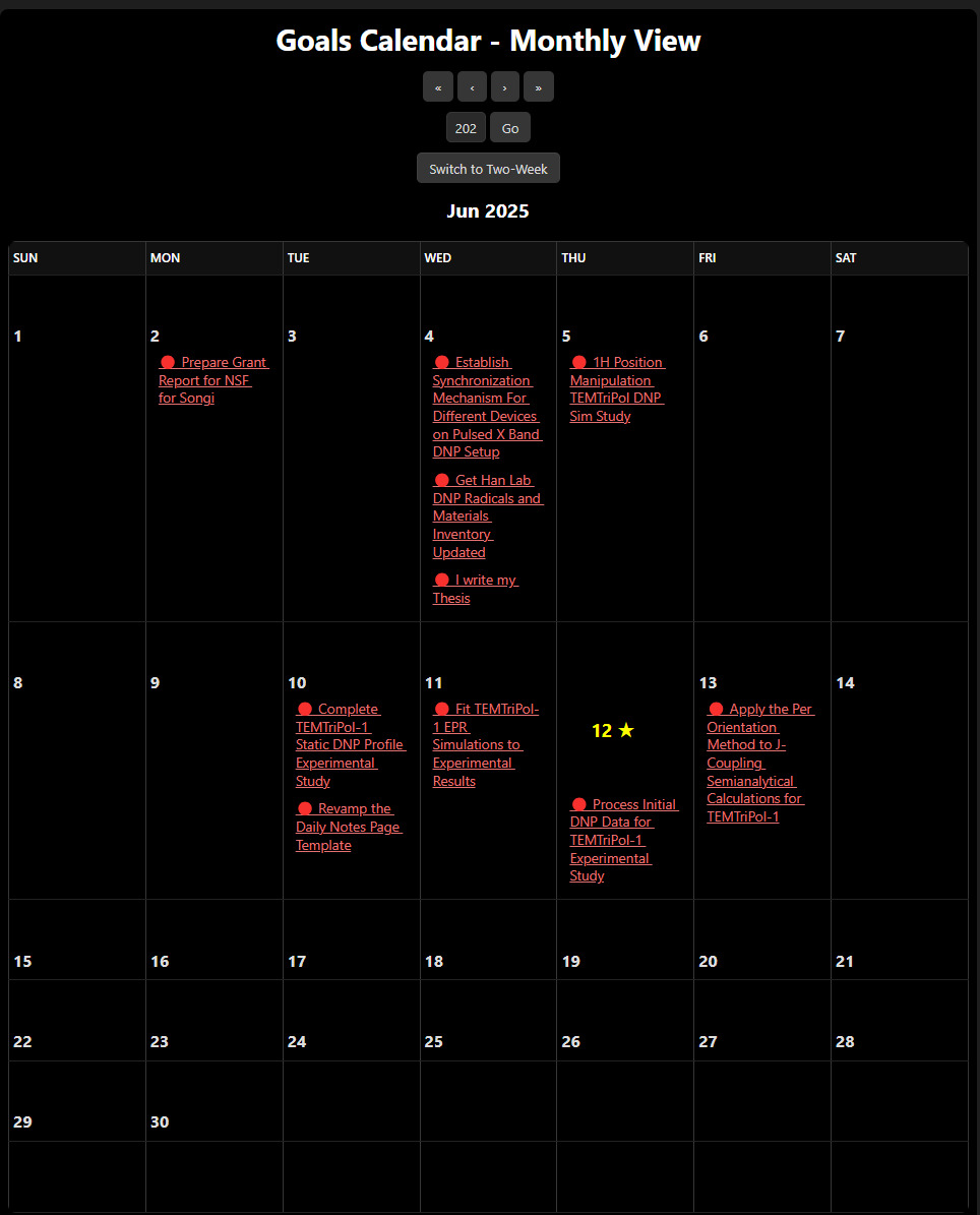

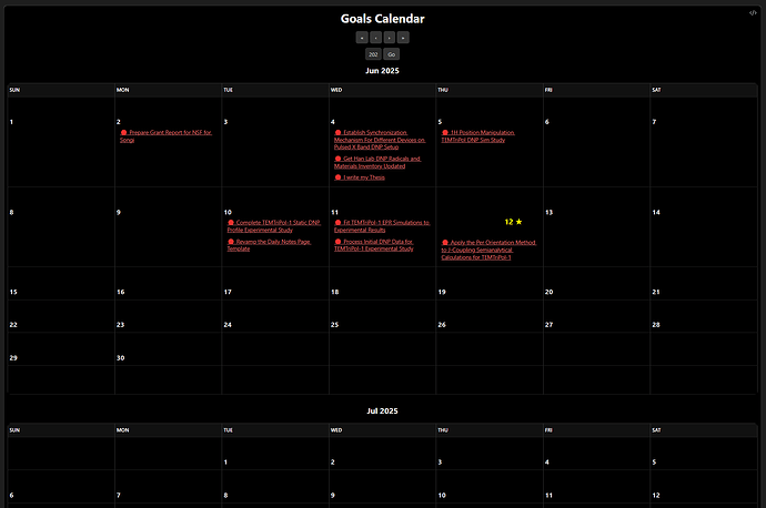

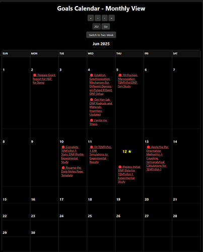

I managed to pull it off!
This is the dataviewjs code that I used (on bottom), as well as the render. (also thanks AI for making it significantly easier to figure this out!)
Basically, I can move the notes around from one spot to the other in the calendar. I have two months at a time in case I need to move cross-months because I am close to the end of a month. If I move it, then the “scheduled” property changes in accordance to where it is moved. I can jump years and months to see what was there at those times (though scheduling jumping isn’t implemented here, though I also don’t need to jump far for that anyway for my use case). The current date is marked with a yellow star, and any complete projects are updated by a frontmatter property to be green, and same for obsolete or incomplete projects respectively.
Some things can be improved (for example, the “click-and-drag” feature to move a project over a date has some glitch where I have to do it twice for it to stick, and the positioning of the date number and star is a bit weird for the current date) but overall I’m satisfied with this implementation! And I’m surprised I can achieve this with only dataviewjs!
Please feel free to use or tweak this code to improve your own projects. I know I’ve been hunting for something like this for a long while, and that makes me think many others are in the same boat.
It would be nice to see this implemented in an actual plugin. For my own use case I don’t think I need it as a plugin if I have this, but since the category I posted this in was “plugin ideas” I am guessing I should leave this up until a plugin of this is made.

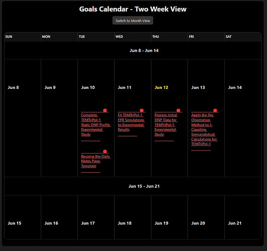

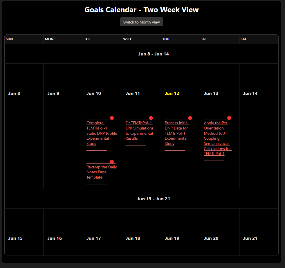

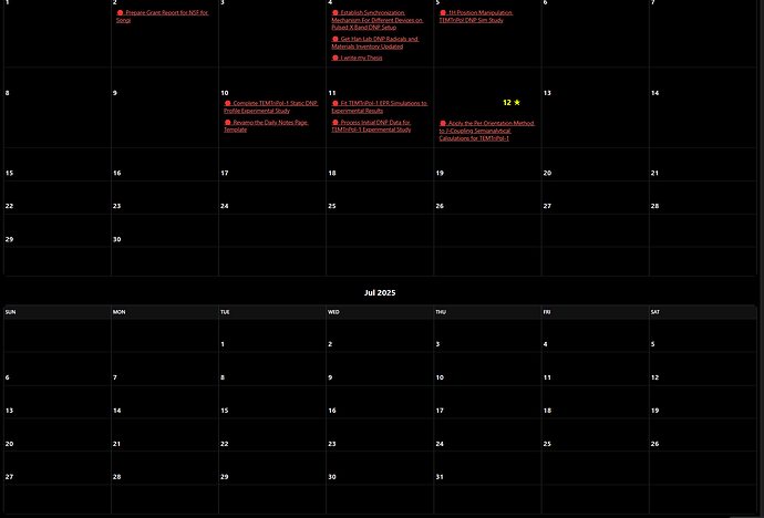

Updates:
So first, I messed around a bit and also now have a 2-week view that can be toggled from the 2-month view, and have attached it here.
Second, it looks like the Tasknotes Plugin has just today released an update (3.0.0) that provides the exact functionality described in this post! It includes a drag-and-drop calendar for notes. There are still some bugs and some features I’d like to see in there (particularly some features I was able to see here in dataviewjs), but I’m certain that as that plugin develops it will cover those!
So I think I can close this topic now that that plugin exists.

  // ─── Function: Build Month HTML (same as your original) ───
  function buildMonth(y, m, eventsByDay) {
    const first = new Date(y, m, 1),
      offset = first.getDay(),
      days = new Date(y, m + 1, 0).getDate();
    let d = 1;
    let html = `
      <div style="
        text-align:center;
        font-size:1.2em;
        font-weight:bold;
        margin-bottom:2px;
        color:#fff
      ">${MONTHS[m]} ${y}</div>
      <table>
        <thead>
          <tr>${WEEKDAYS.map(w => `<th>${w}</th>`).join("")}</tr>
        </thead>
        <tbody>
    for (let wk = 0; wk < 6; wk++) {
      html += "<tr>";
      for (let wd = 0; wd < 7; wd++) {
        if ((wk === 0 && wd < offset) || d > days) {
          html += `<td style="height:70px"></td>`;
        } else {
          const isToday =
            y === today.getFullYear() &&
            m === today.getMonth() &&
            d === today.getDate();
          let dayNumberHtml = "";
          if (isToday) {
            dayNumberHtml = `<div style="font-weight:bold; color:yellow; font-size:1.1em">
                               ${d} ★
                             </div>`;
          } else {
            dayNumberHtml = `<div style="font-weight:bold">${d}</div>`;
          html += `<td class="${isToday ? "today" : ""}"
                      data-year="${y}"
                      data-month="${m}"
                      data-day="${d}"
                      style="height:70px"
                      ${dayNumberHtml}`;
          (eventsByDay[d] || []).forEach(n => {
            const ach = n.achieved_status, st = n.status;
            let icon = "", col = "";
            if (ach === true) { icon = "🟢 "; col = "#81c784"; }
            else if (st === "obsolete") { icon = "💀 "; col = "#ffb74d"; }
            else if (ach === false) { icon = "🔴 "; col = "#e57373"; }
            html += `<a class="internal-link ev-pill" draggable="true" data-path="${n.file.path}"
                          style="color:${col}"
                     >${icon}${n.file.name}</a>`;
          html += "</td>";
          d++;
      html += "</tr>";
    html += "</tbody></table>";
    return html;
  // ─── Render the Monthly View ───
  function renderMonthView() {
    // Gather events for the current month and the following month
    const nextM = month < 11 ? month + 1 : 0,
      nextY = month < 11 ? year : year + 1;
    const ev1 = {}, ev2 = {};
    dv.pages(`"=Notes/=Situations"`)
      .where(p => p.scheduled)
      .forEach(n => {
        const dt = dv.date(n.scheduled);
        if (!dt) return;
        const y = dt.year, m = dt.month - 1, d = dt.day;
        if (y === year && m === month) (ev1[d] ||= []).push(n);
        if (y === nextY && m === nextM) (ev2[d] ||= []).push(n);
    const wrap = document.createElement("div");
    wrap.id = "dvCalWrapper";
    wrap.style.cssText = "display:flex;flex-direction:column;gap:8px";
    wrap.innerHTML = `
      <div style="text-align:center;font-size:1.8em;font-weight:bold;color:#fff;margin-bottom:2px">
        Goals Calendar - Monthly View
      </div>
      <div style="display:flex;justify-content:center;gap:4px;margin-bottom:2px">
        <button id="prev-year">«</button>
        <button id="prev-mon">‹</button>
        <button id="next-mon">›</button>
        <button id="next-year">»</button>
      </div>
      <form id="year-form" style="display:flex;justify-content:center;gap:4px;margin-bottom:2px">
         <input id="year-input" type="number" min="0" value="${year}" style="width:3em;text-align:center"/>
         <button type="submit">Go</button>
      </form>
      <div style="text-align:center;margin-bottom:4px">
         <button id="toggle-view">Switch to Two-Week</button>
      </div>
      <div>${buildMonth(year, month, ev1)}</div>
      <div>${buildMonth(nextY, nextM, ev2)}</div>
    container.innerHTML = "";
    container.appendChild(wrap);

  function renderBiweekView() {
    // Calculate start of current week (using Sunday as the starting day)
    let curWeekStart = new Date(today);
    curWeekStart.setDate(today.getDate() - today.getDay());
    let daysArr = [];
    for (let i = 0; i < 14; i++) {
      let d = new Date(curWeekStart);
      d.setDate(curWeekStart.getDate() + i);
      daysArr.push(d);
    // Gather events that fall within the two-week window.
    let eventsByDay = {};
    const endDate = new Date(curWeekStart);
    endDate.setDate(curWeekStart.getDate() + 13);
      .forEach(n => {
        if (!dt) return;
        let sched = new Date(dt.year, dt.month - 1, dt.day);
        if (sched >= curWeekStart && sched <= endDate) {
          const key = sched.toISOString().split("T")[0];
          (eventsByDay[key] ||= []).push(n);
    // Build the biweek calendar with a header row to indicate the week ranges.
    let html = `
      <div style="text-align:center;font-size:1.6em;font-weight:bold;color:#fff;margin-bottom:2px">
        Goals Calendar - Two Week View
      </div>
      <div style="text-align:center; margin-bottom:4px">
         <button id="toggle-view">Switch to Month View</button>
      </div>
      <table>
        <thead>
          <tr>${WEEKDAYS.map(d => `<th>${d}</th>`).join("")}</tr>
        </thead>
        <tbody>
    for (let week = 0; week < 2; week++) {
      // Add a header row for each week with its date range.
      const firstDay = daysArr[week * 7];
      const lastDay = daysArr[(week * 7) + 6];
      html += `<tr>
                 <td colspan="7" style="text-align:center;font-weight:bold;color:#fff;background:#111;padding:2px;">
                   ${MONTHS[firstDay.getMonth()]} ${firstDay.getDate()} - ${MONTHS[lastDay.getMonth()]} ${lastDay.getDate()}
                 </td>
               </tr>`;
      html += "<tr>";
      for (let i = 0; i < 7; i++) {
        let dayObj = daysArr[week * 7 + i];
        let key = dayObj.toISOString().split("T")[0];
        let isToday = dayObj.toDateString() === today.toDateString();
        let dayNumberHtml = `<div style="font-weight:bold; ${isToday ? "color:yellow;" : ""}">
                              ${MONTHS[dayObj.getMonth()]} ${dayObj.getDate()}
                             </div>`;
        html += `<td class="${isToday ? "today" : ""}" data-date="${key}" style="height:70px; vertical-align:top;">
                   ${dayNumberHtml}`;
        (eventsByDay[key] || []).forEach(n => {
          html += `<a class="internal-link ev-pill" draggable="true" data-path="${n.file.path}" style="color:${col}">
                   </a>`;
        html += `</td>`;
      html += "</tr>";
    html += `</tbody></table>`;
    wrap.innerHTML = html;
    wrap.querySelector("#toggle-view").onclick = () => {
      viewMode = 'month';
      render();
