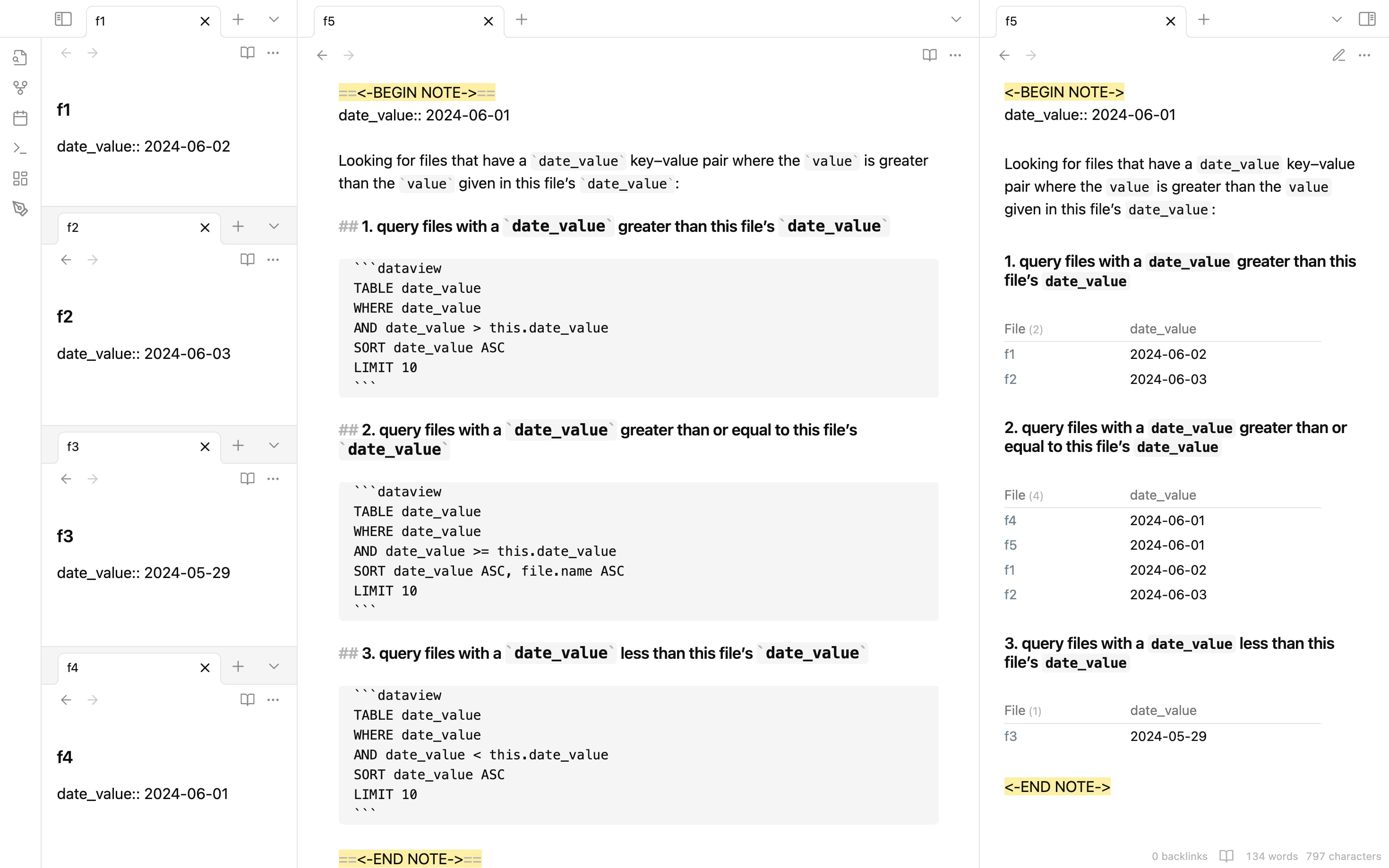

Or perhaps something along these lines?
==<-BEGIN NOTE->==
date_value:: 2024-06-01
Looking for files that have a `date_value` key–value pair where the `value` is greater than the `value` given in this file’s `date_value`:
## 1. query files with a `date_value` greater than this file’s `date_value`
```dataview
TABLE date_value
WHERE date_value
AND date_value > this.date_value
SORT date_value ASC
LIMIT 10
## 2. query files with a `date_value` greater than or equal to this file’s `date_value`
```dataview
TABLE date_value
WHERE date_value
AND date_value >= this.date_value
SORT date_value ASC, file.name ASC
LIMIT 10
## 3. query files with a `date_value` less than this file’s `date_value`
```dataview
TABLE date_value
WHERE date_value
AND date_value < this.date_value
SORT date_value ASC
LIMIT 10
==<-END NOTE->==

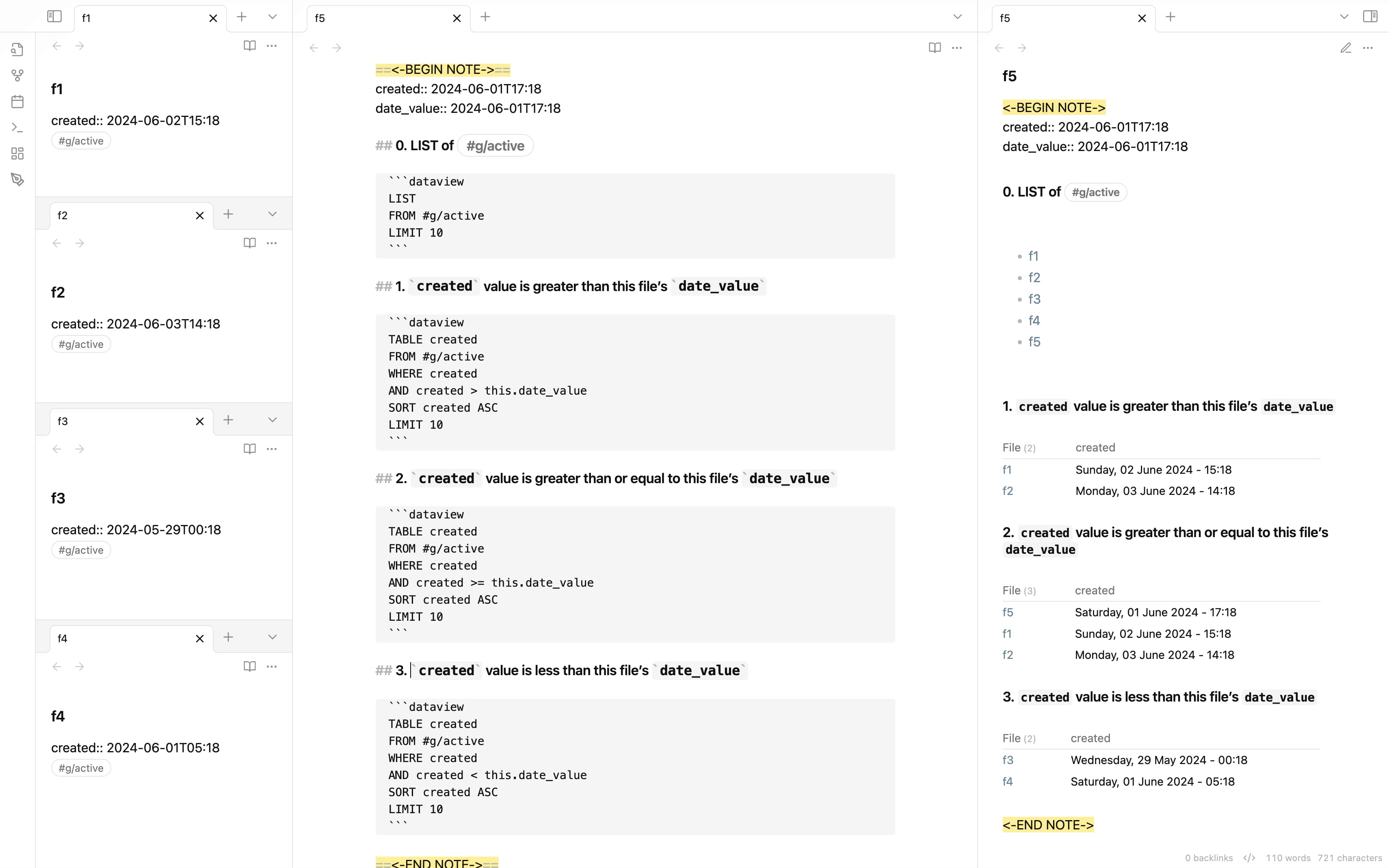

Something like this?
==<-BEGIN NOTE->==
created:: 2024-06-01T17:18
date_value:: 2024-06-01T17:18
## 0. LIST of #g/active
```dataview
LIST
FROM #g/active
LIMIT 10
## 1. `created` value is greater than this file’s `date_value`
```dataview
TABLE created
FROM #g/active
WHERE created
AND created > this.date_value
SORT created ASC
LIMIT 10
## 2. `created` value is greater than or equal to this file’s `date_value`
```dataview
TABLE created
FROM #g/active
WHERE created
AND created >= this.date_value
SORT created ASC
LIMIT 10
## 3. `created` value is less than this file’s `date_value`
```dataview
TABLE created
FROM #g/active
WHERE created
AND created < this.date_value
SORT created ASC
LIMIT 10
==<-END NOTE->==
