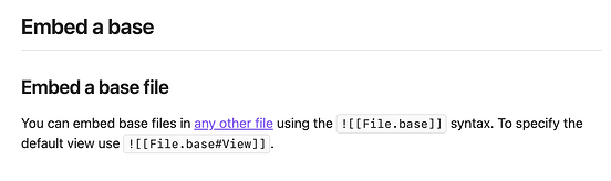

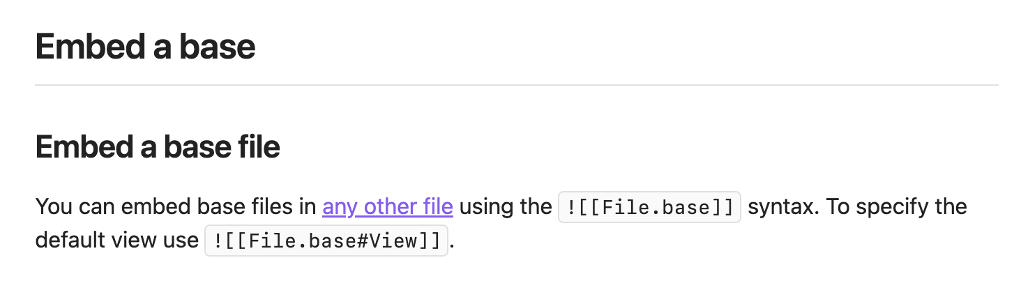

https://help.obsidian.md/bases/create-base#Embed+a+base
Perfect, that’s what I needed. Thanks!
