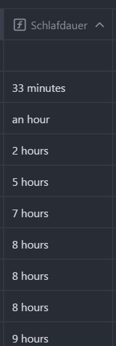

I got awfully curious (
) about displaying the resulting difference between the 2 date/times formatted as h:mm and I got something
The math isn’t necessarily pretty to look at so I divided the logic into multiple formulas
The 1st step is to determine the difference between dt2 and dt1 as a whole, in ms which is done using the formula (in the column titled diff (ms)):
number(dt2) - number(dt1)
