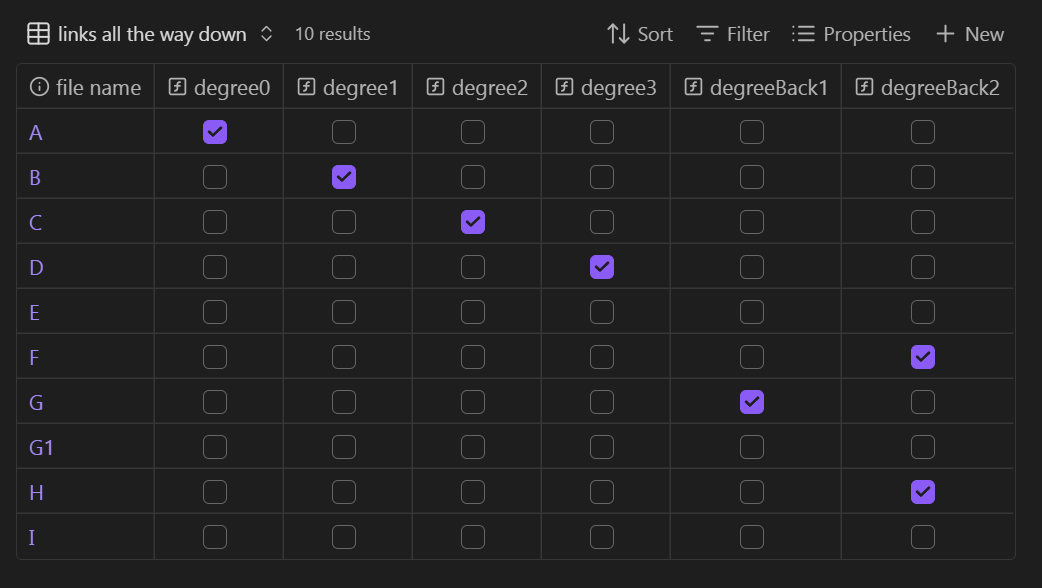

Matrix
Here’s a visual. I added notes:
  • H (H links to G)
  • G1 (G links to G1)
  • I (no links)
Note how formula.degreeBack2 branches to F. It can be filtered for; I just stopped writing at that point because I don’t know your specs.
Hopefully this has enough depth for you or the GPT to continue the patterns the way you want.
  1. In the full base, the formulas are written directly into the filters and do not have names. I named them in the explanation just to show what they’re doing. ↩︎
