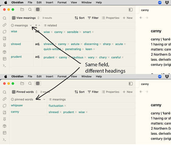

Right now, when you create different views in a Base, you can only change the heading for a particular column across Views. I am using Bases in the sidebar, displaying various relationships to the current note, so headings for views displaying different types of relationships become misleading.
(See image below for the illustration)
In my specific case, a Glossary, I require different headings for note title (default heading “name” in Bases) in two Views–“Meaning,” for showing synonyms and “Pinned word,” for showing words I want to use in writing. But in a current setup I cannot do that so “Meaning” or “Pinned word” would stay in place even though it is irrelevant and misleading for the other view.
It would be great if column headings were particular to Views in a Base.
Thanks!

Thank you so much! I didn’t think of this. This solution is a bit convoluted but it works and solves my issue. Good to know for the future too.
