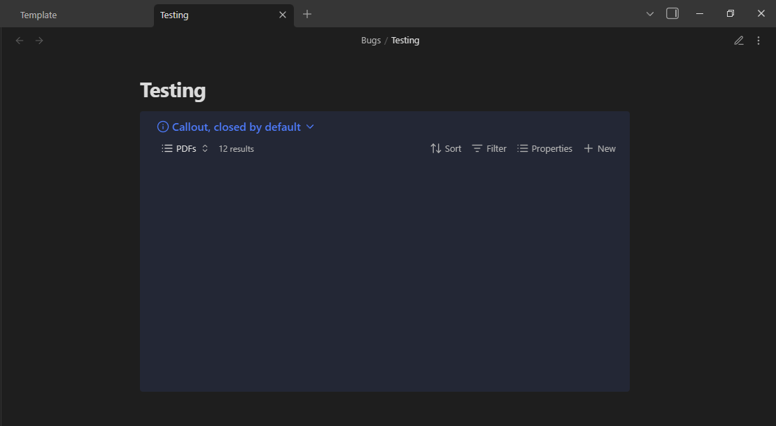

Description
When you have a list-type base-from-codeblock in a callout that is closed by default, and it is showing results whose underlying filesizes are “large enough”, then when expanding the callout from minimized state the list view is empty.

  6. In reading view, click the arrow of the callout to show its results.
When “unminizing” the callout, we expect the list view to show the PDFs with combined “large enough” filesize we’ve added to the included folder.
The list is empty, see below image:
It is important to note that on any change to the files of the vault (a modification to an existing file, a new attachment/file, ..), the list view that is visible in the callout refreshes and correctly shows the items.
