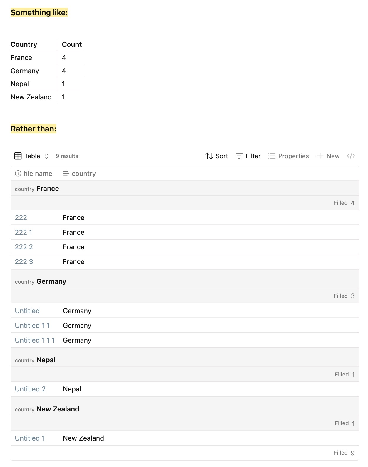

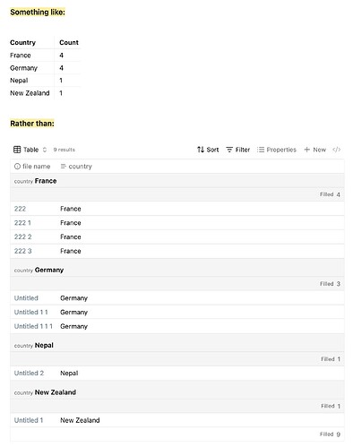

In daily notes (yyyy-mm-dd) I record the country I am in each day with country: Name of Country.
With Bases, I can query all the notes for a given year and then group by and sum the country values – see sample screenshot below.
Is it possible to only show the filled totals, without having to have hundreds of rows in the note?

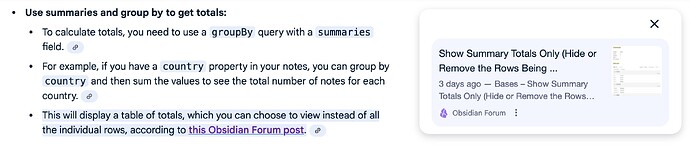

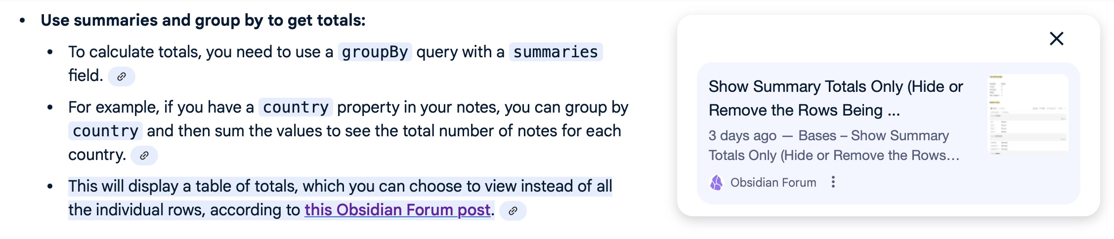

Still trying to figure this out. Smiled when I just saw that Google AI currently thinks that the ‘solution’ to my question is my question :person_facepalming:
Wonder if Google will now add this post to its ‘solution’.

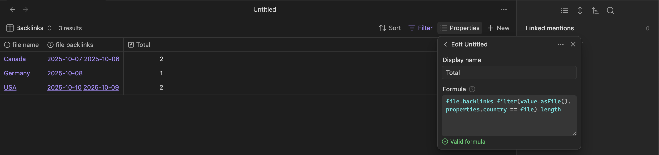

But then, to get the count you could use a formula similar to :
file.backlinks.filter(value.asFile().properties.country == file).length
… or something else, depending on the metadatas of your daily notes :blush:

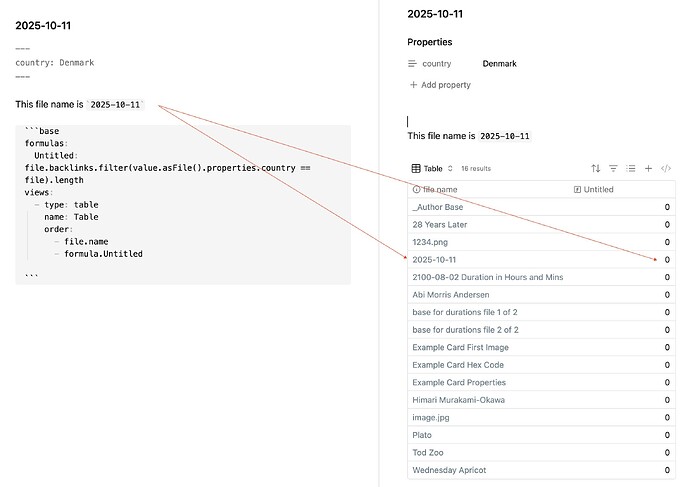

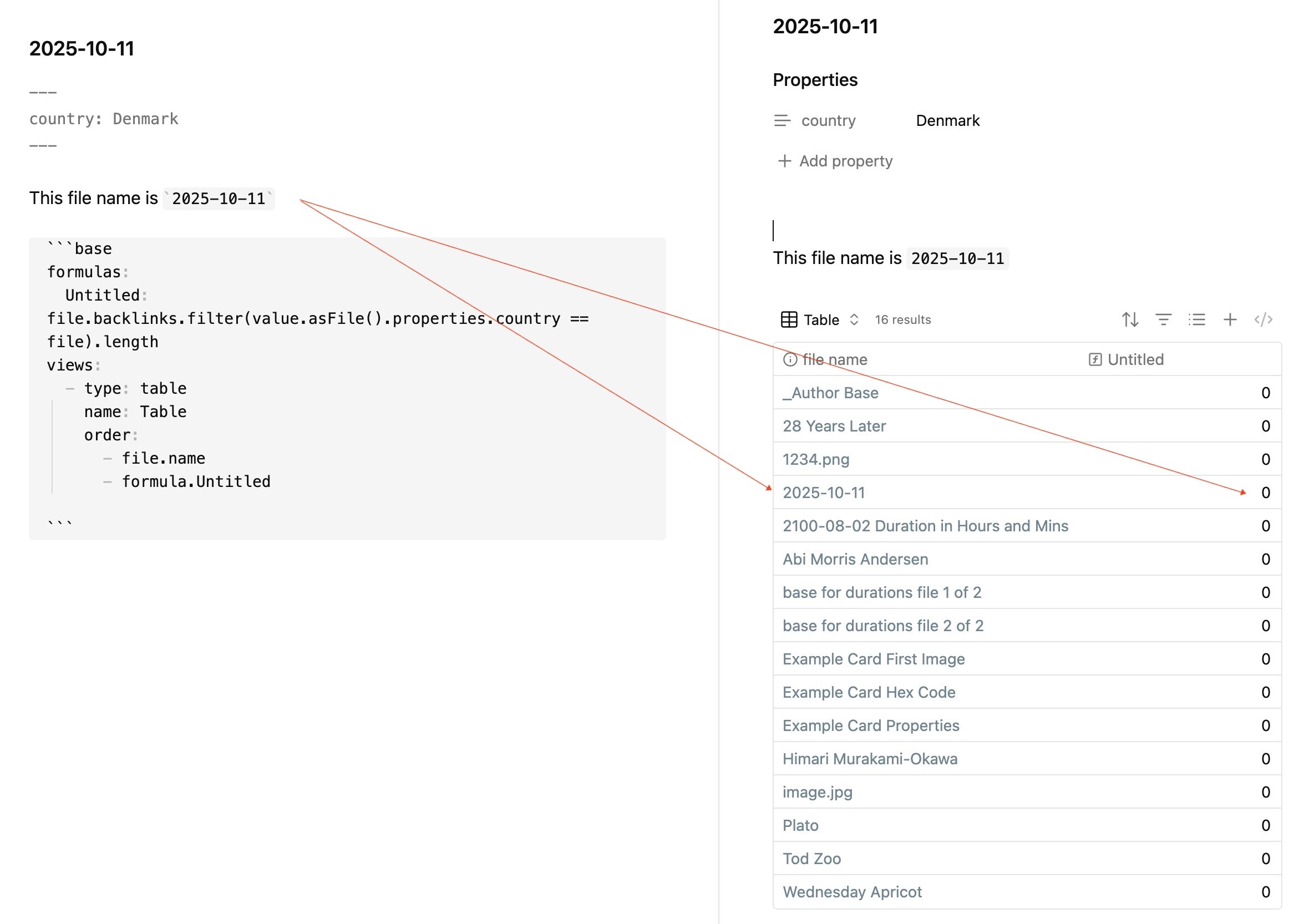

If I add a simple daily note in my test vault and use the filter suggested:
  1. I see a count of 0, and I don’t see the country name
  2. I see all files in the test vault
  3. I see lots of rows in the table, not just the summary totals
I am clearly lost. Grateful for any pointers.
country: Denmark
This file name is `2025-10-11`
```base
formulas:
  Untitled: file.backlinks.filter(value.asFile().properties.country == file).length
views:
  - type: table
    order:
      - file.name
      - formula.Untitled

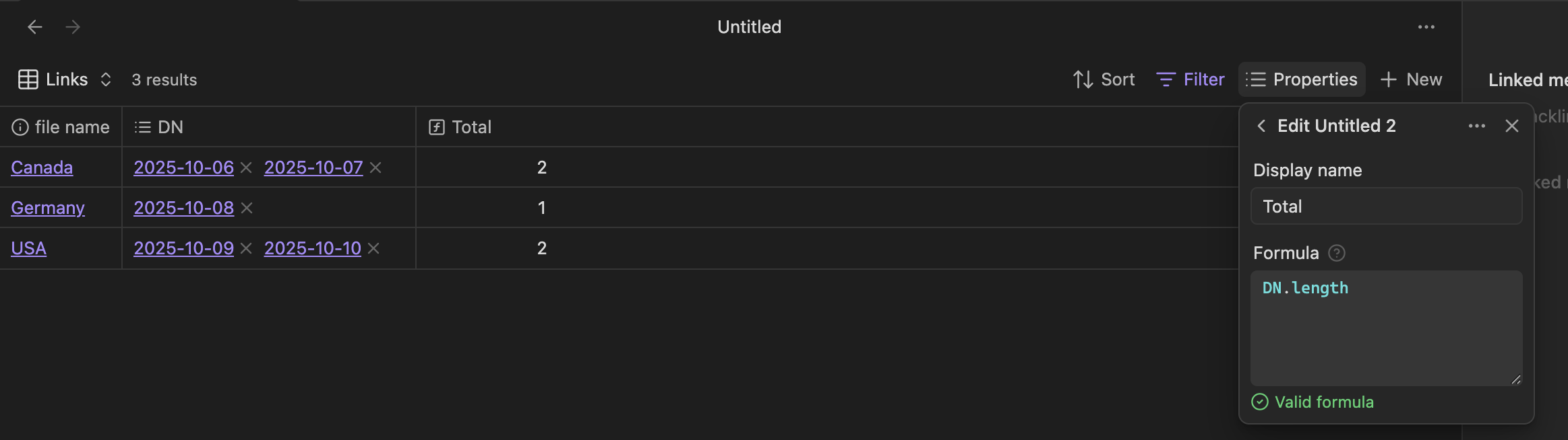

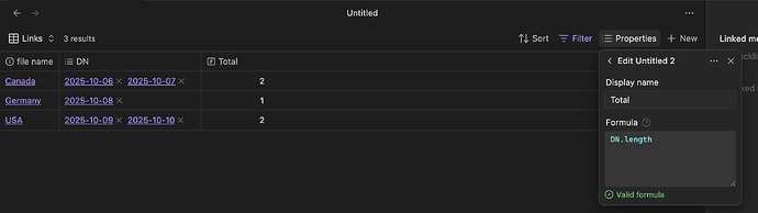

After days spent chasing my own tail, I have decided, while I still have a single atom of sanity left, to give up on the idea of getting this to work in my vault . Pch (above) has shown the feasibility of what I have tried to do, so hopefully Google’s AI will now refer to their post instead of the garbage in my original question.
Thanks, Pch :raising_hands: :star_struck:
