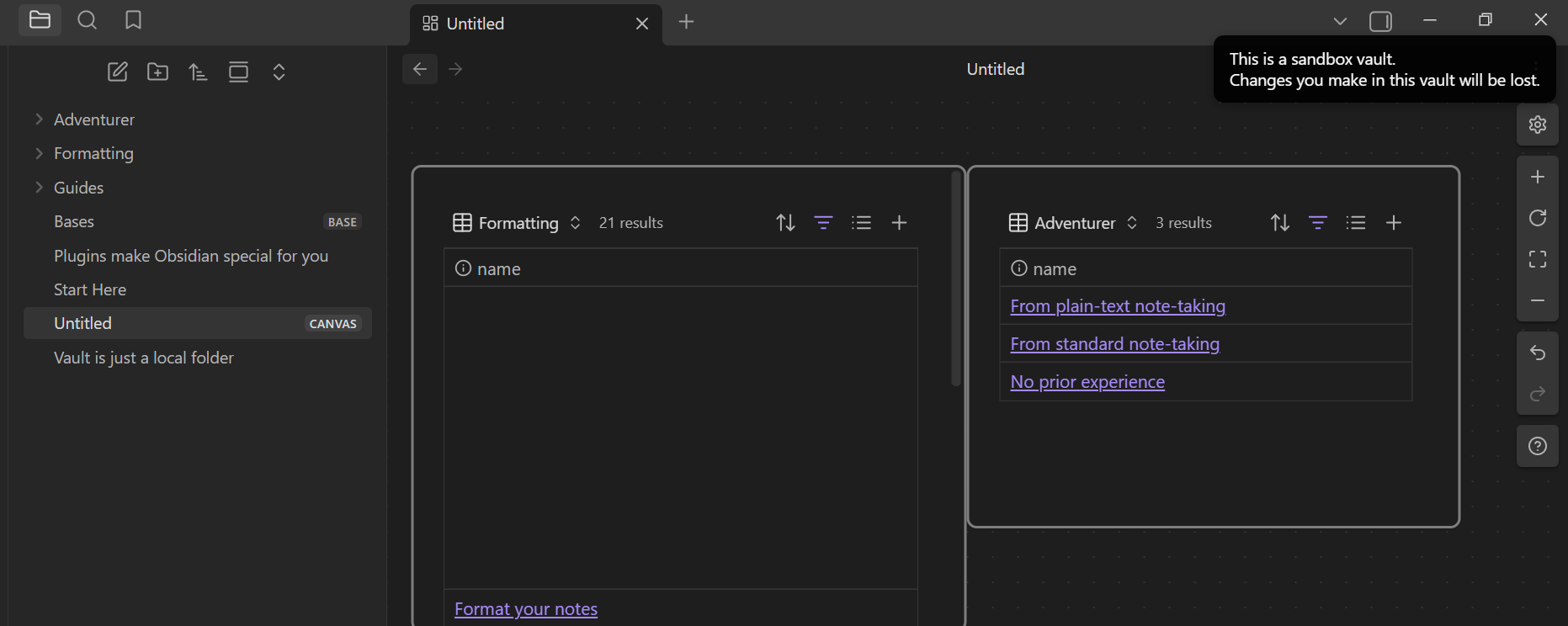

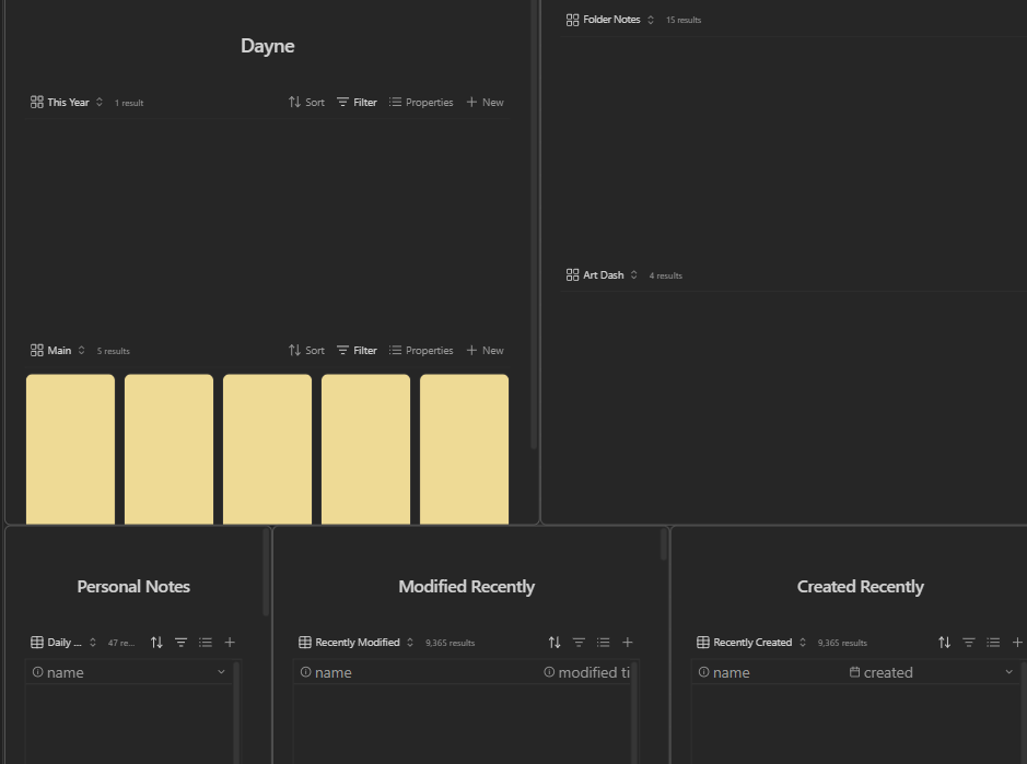

Here’s some photos~
Not sure if this is relevant or helpful info, but dataview works fine in terms of panning out of active area and coming back.
I would also like to add that this also happens to embedded markdown files in my canvas with bases in them.
Can you please post a screen recording of this happening in teh sandbox vault?
I am not sure about the exact repro steps.

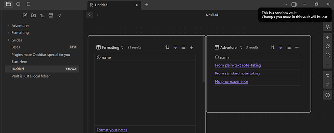

Of course~🫡
Here’s a video; I wasn’t sure how to embed it so I put a link. The issue mainly happens with panning. If it’s only zooming in and out, the bases render fine
Just some additional info:
  • The bases I added in the sandbox don’t have any filters but it happens with filtered views as well.
  • I’ve panned using right click on the first instance. Space Bar + Left Click on the second instance. Sometimes one base or two renders - but would probably say both methods have pretty similar variances. :thinking:
