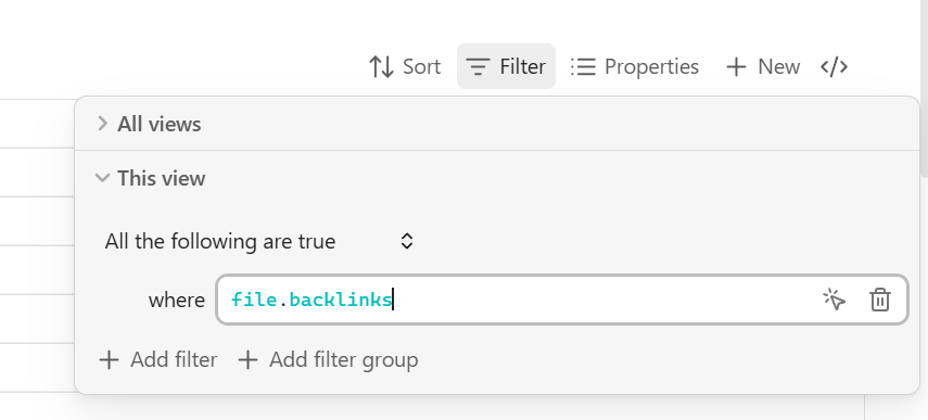

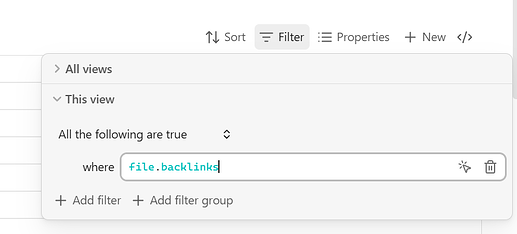

In Properties, when you start typing “backlinks”, you should see it and be able to select it:
In Filter, it’s not in the drop-down list. You have to click the code icon to toggle the Advanced filter and type in your filter:
