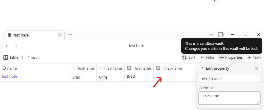

Creating a property using a function does not work if the function references an existing property that has a hyphen (“-”) in the property key, for example first-name. The same function does work when you reference a key that do not have hyphens in the name.
  1. Create a note and add a property with a hyphen in the key, e.g. first-name. Also add a property with no hyphen in the key, e.g. firstname. Put a value for each property.
  2. Create a Bases and filter so you see the note you created.
  3. Add the firstname and first-name properties so you can see the values
  4. In the Base, create a new property with the formula firstname, this will work as expected
  5. In the Base, create a new property with the formula first-name, this field will be empty
Yes, and I recreated the bug in the sandbox vault. See the screenshot below.
The new property that references a property with a hyphen in the key should show the value for that property.
The new property is blank.

Try note["first-name"].

In formulas it conflicts with subtraction so you’ll need to write it as note[“dates-recorded”]
