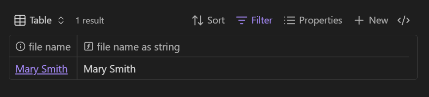

4.
Create a new base in “Mary Smith.md”.
Add this filter:
file.path == this
Add this property formula:
file.name.toString()
Does the column value show exactly Mary Smith, or is anything amiss with the string?
