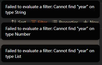

Thanks a lot but this is not working.
I have a property named “date-read” for when I finish the book of “date” type.
The are the two errors I’m getting:
Filed to evaluate a filter. Type error in "date", parameter "input". Expecting String given Number
and
Filed to evaluate a filter. Type error in "date", parameter "input". Expecting String given List
Thanks a lot but Bases is giving the error that it can’t find function “slices” in Date.

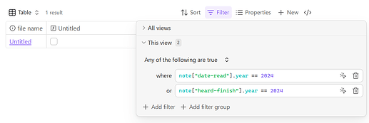

and maybe a way to have the possibility to filter for date-read OR heard-finish (for audiobooks)
To do “or” in the Filter maker, select “Any of the following are true”, like this:
Here’s what it looks like in code:

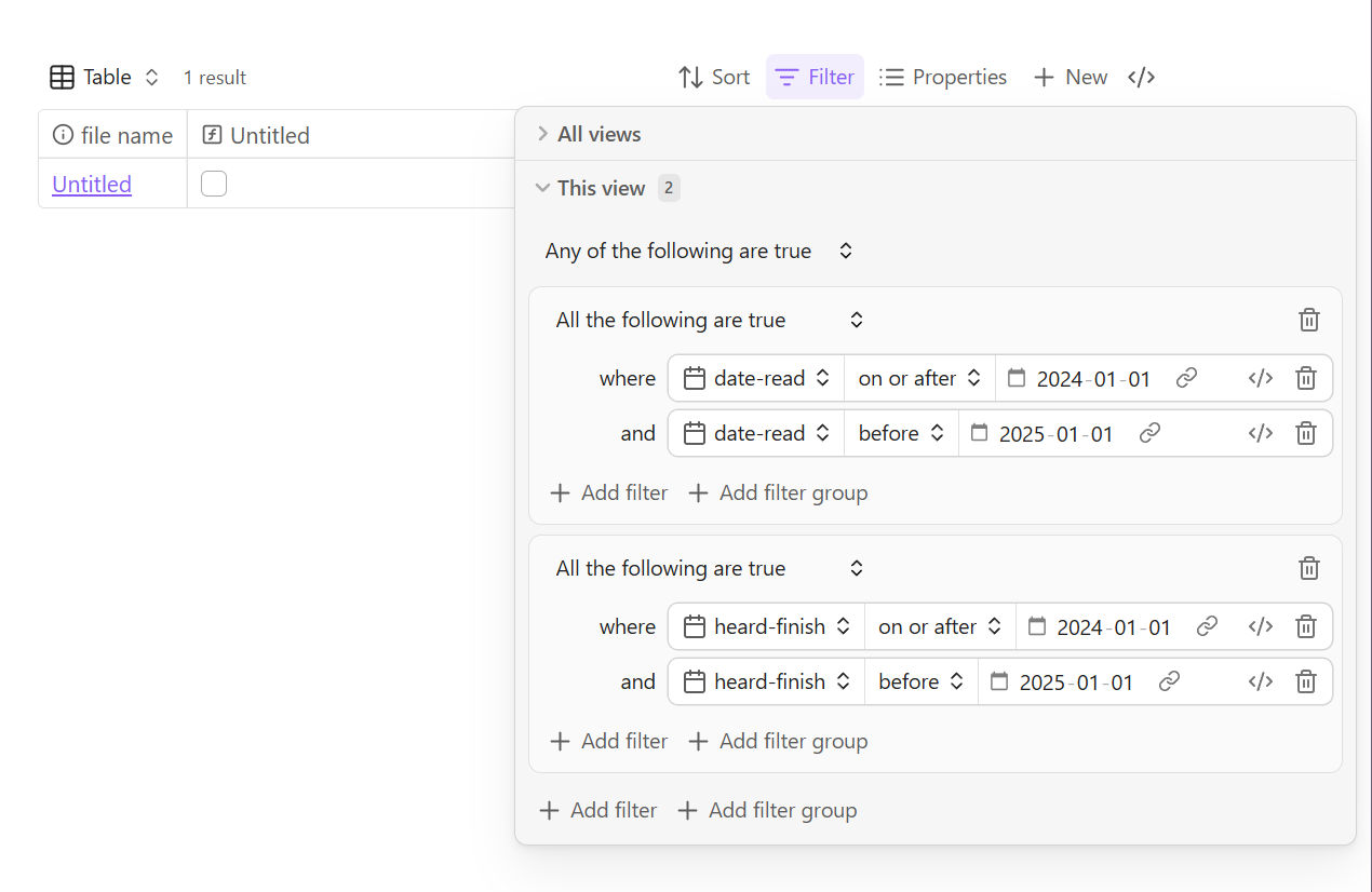

Alternatively, if you would rather use the filter pairs you shared, then you could click “Add filter group” to create groups with “or” and “and”, like this:
In the code, it’s:

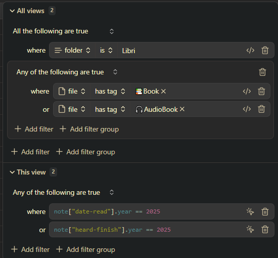

Your solution is working (today, yesterday I didn’t get any result. I don’t understand why but since Informatics is an exact science… :rofl:)
These are my filters and now is working (tried with 2025 since there are less books)
Bases is still complaining about:
but I’m getting the correct results.
I wish I could understand why this error but hope to get what I need also tomorrow :rofl:
Thanks for your help and your patience!
Glad you got the formula working!
That error message means some of your date-read and/or date-heard values are in a format that is not a date, per Bases’s interpretation. It means that notes with the “incorrect” format won’t show up in your results, even if they are from the year you entered.
Several things can make the date format incorrect for Bases, such as being in a list, having a time zone offset, slashes instead of dashes, the year at the end instead of the beginning, or an number that’s out of range (like 2025-13-50).

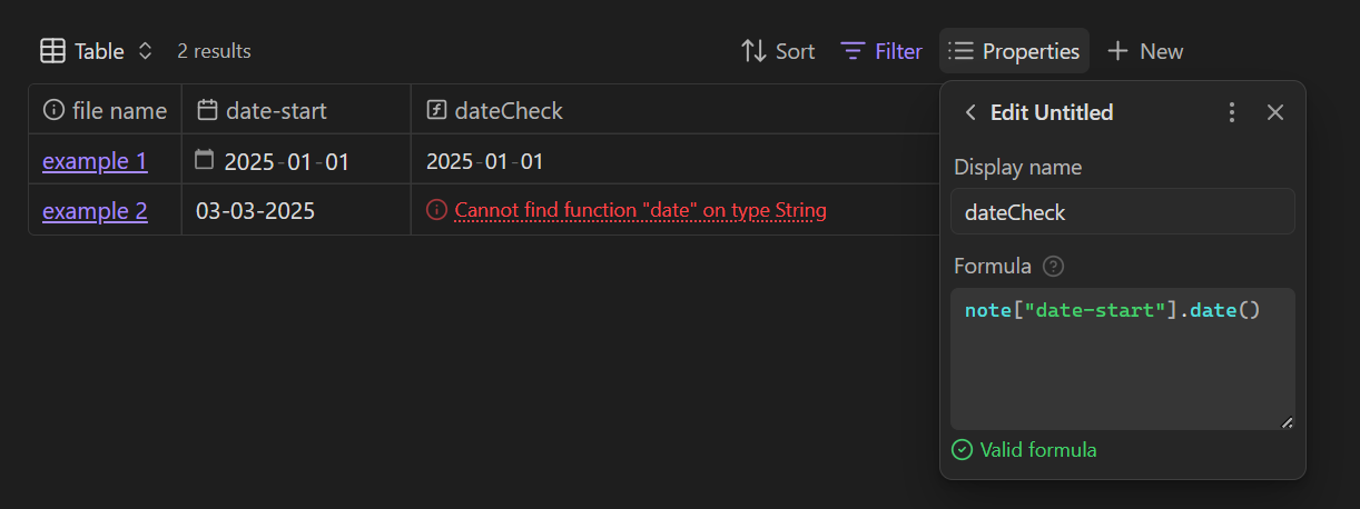

If you want to clean the property values, one way to try to find those notes is to make a separate base with this filter:
note["date-start"]
… and this property formula:
note["date-start"].date()
That ought to show you which date-starts aren’t dates, like this:
And then do the same for heard-finish.
