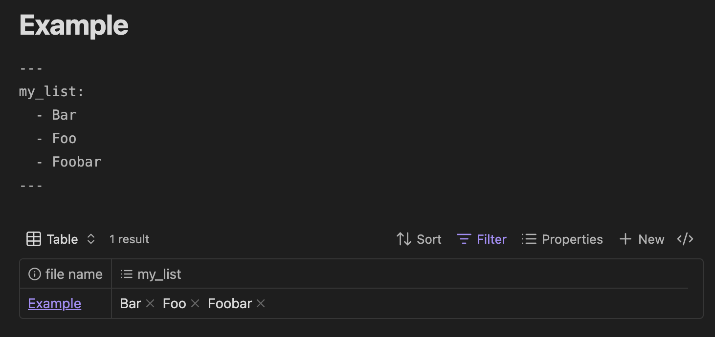

I don’t understand your problem… Columns with properties of type list are correctly shown in my case:
Perhaps the problem is that the property is not of type list in your case? You can use the “All properties” side panel to ensure the type of your properties.
Side note. You can also use join in formulas like this:
my_formula: my_list.join(", ")
but I think it is preferable to use directly the property column, because that way you can easily edit the list in the table view.

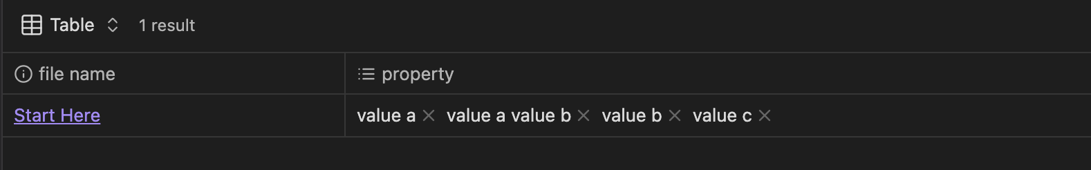

I’m sorry but I’m really not sure what you mean by this :sweat_smile: :
I mean, if I copy/paste your example in a note in the sandbox vault and select the property to be displayed in the base, I get this:
… where each item has a x on the right to be able to remove it … like in Properties in Live Preview
Have to apologize, I was on mobile and oversaw a stupid mistake - yes, also in my simplified test data… That gave me the impression the behavior is odd/ not working as expected.
