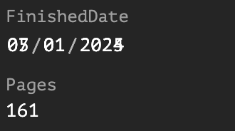

Bases dates appear overlapped

The thing is that the end result is the dates appear overlapped. It is not really a huge issue, if I want it to appear more visually pleasing I can just remove that property, I would loose that info on sight when opening the bases view.
Just wondering if someone could have a work around for this, or if it is a limitation of bases for now given that it was more or less recently released

Glad you posted this. I’ve been suspecting it’s a bug but hadn’t seen a single mention thus didn’t get around to making a bug report… until seeing that you’re facing it too.
new Bug report here
Well. Good to know I am not the only one ahah thanks
Renamed thread to describe the problem being asked about (was “Retrieve notes from list properties in bases”), and marking the link to the bug report as the solution.
Thank you
