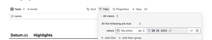

Bases: date comparison against file.ctime mtime are incorrect
  1. Create an empty base that shows all files
  2. add filter for All views, where “file.ctime” is “on” and pick a date, e.g. todays date
  3. done
All files created today should be shown.
Empty list is shown.

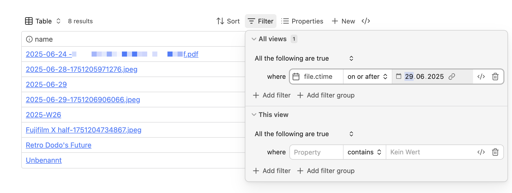

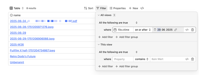

BUT after changing to “on or after” it does work. (In the screenshot I chose today’s date and because there are no files created in the future all files shown have been created today.)

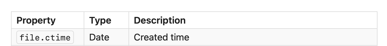

Yes, the UI is wrong. ctime is datetime, so you should be asked to provide a time as well.

Thanks! UI wise, does it makes sense to compare a datetime with “on” to another datetime? How big are the chances that they will be the same?
A user, that wants to use the UI and not the more complex syntax, I think, would always want the ability to compare e.g. the file creation date with another date … Any chance for the addition of file.cday maybe?
BTW maybe this could be clarified in the help as well? Right now it is called “.ctime”, has type “Date”, but the Descriptions states “time”. The type might be “DateTime” and the description “Created date with time”? (As a non-programmer this is quite confusing to me.)
