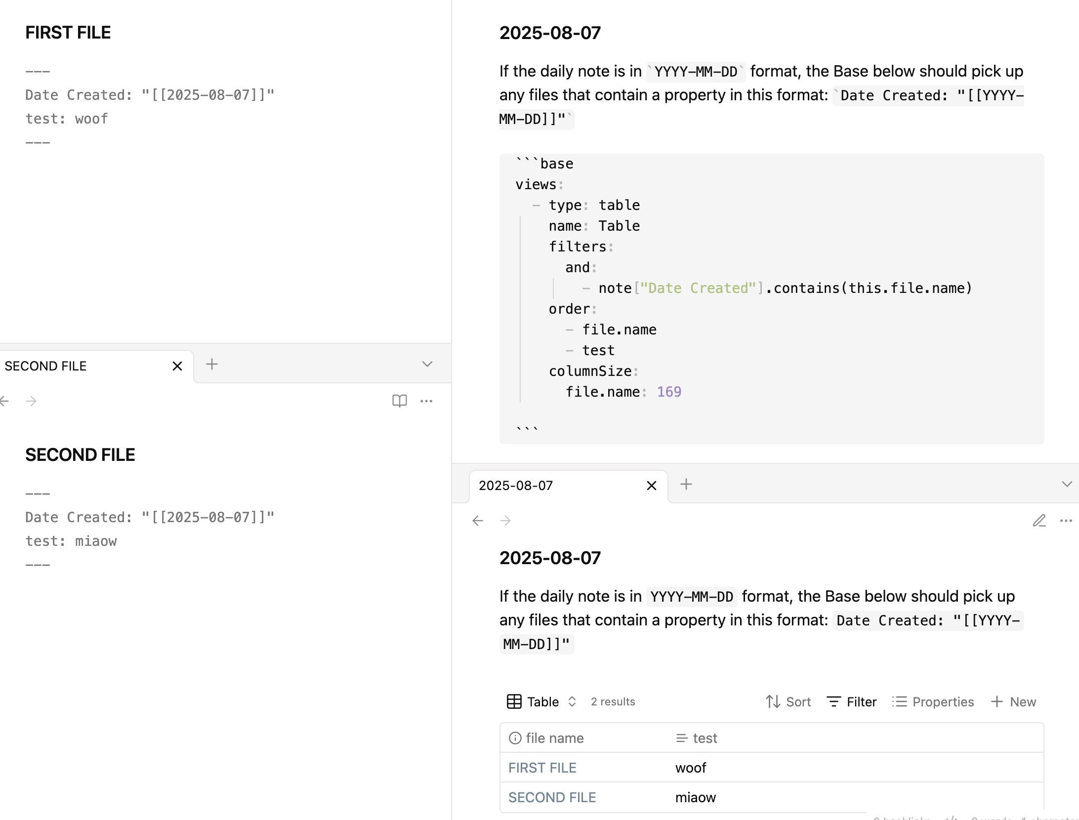

Hello.
If the daily note is in YYYY-MM-DD format, the Base below – if placed in the daily note – should pick up any files that contain a property in this format: Date Created: "[[YYYY-MM-DD]]"
views:
  - type: table
    filters:
      and:
        - note["Date Created"].contains(this.file.name)
    order:
      - file.name
      - test
    columnSize:
      file.name: 169
Is this what you want, or closer to what you want? :four_leaf_clover:
