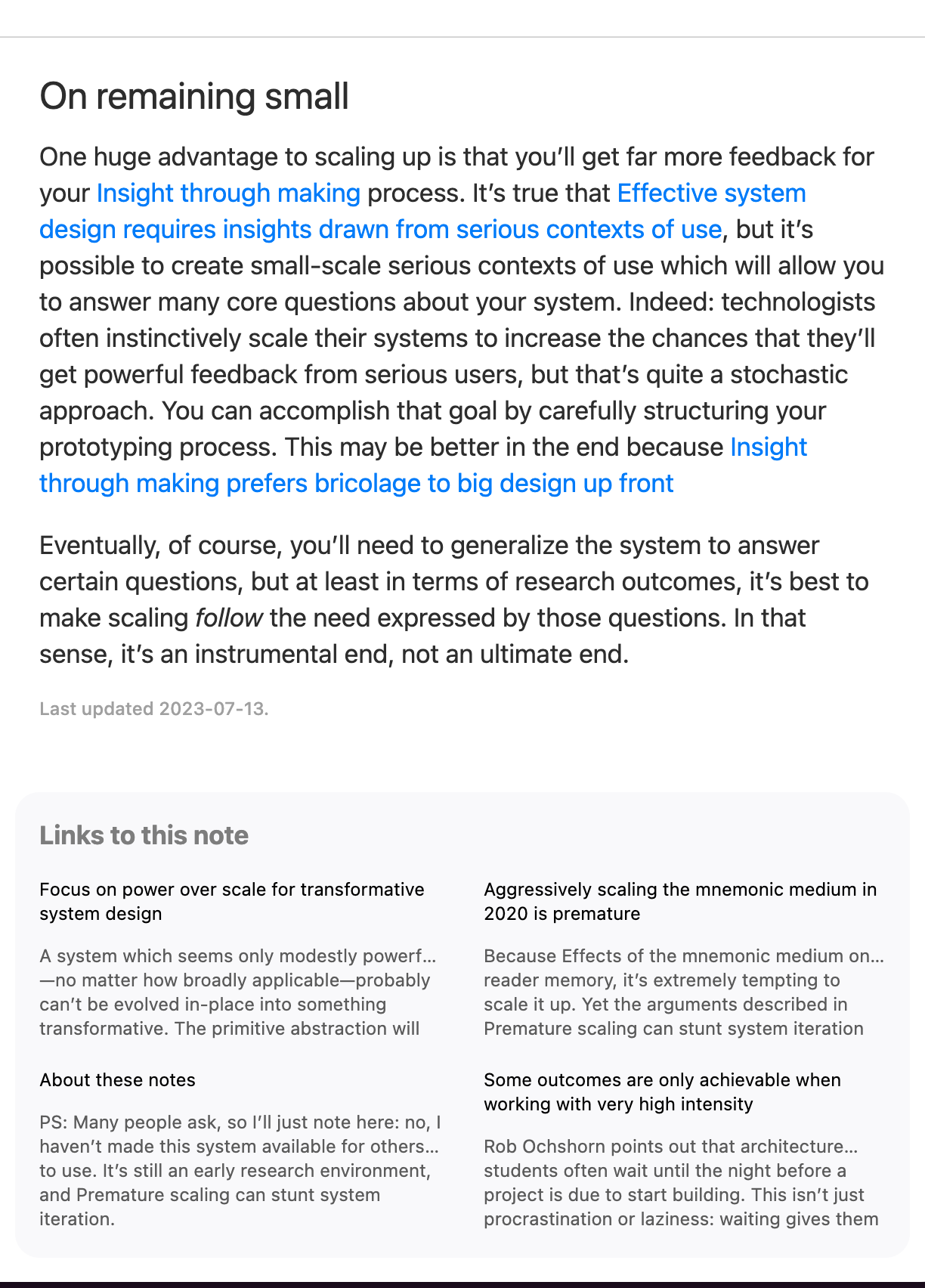

Backlink pane css changes (like Andy Matuschak's)

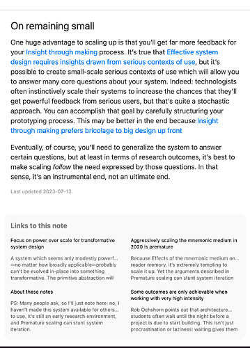

I have been noticing that there isn’t a lot of discussing about using CSS on the backlink pane, but Andy Matuschak’s public notes seem to me like a beautiful model of how this could be done:
CSS can only manipulate or change what’s already there (with a few exceptions using pseudo-classes).
I agree the above looks great and would like the option for something like this, but it’s in plugin territory, I reckon.

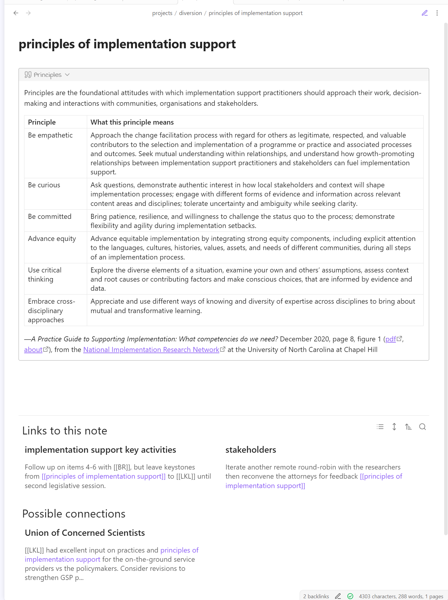

@Sk180, looks cool. I took a peek and imitated the backlinks style in your screenshot, with a few embellishments like accenting the link text, keeping the filters, and thinning the font weight:
I use the backlinks pane in the side dock and not in the footer so don’t know how robust this code is for different scenarios, sizing, etc., but it could be a starting point if anyone wants to do more:
.embedded-backlinks .backlink-pane > .tree-item-self {
	&:first-of-type::before {
		content: "Links to this note";
	&:nth-of-type(3)::before {
		content: "Possible connections";
	&::before {
		font-size: var(--h2-size);
	> :is(.tree-item-inner, .tree-item-flair-outer) {
		display: none;
.embedded-backlinks .backlink-pane .search-results-children {
	display: flex;
	flex-wrap: wrap;
.embedded-backlinks .backlink-pane .tree-item.search-result {
	width: 49%;
	> .tree-item-self {
		font-size: var(--font-ui-large);
		font-weight: var(--font-medium);
		padding-left: var(--size-4-3);
		> :is(.tree-item-icon, .tree-item-flair-outer) {
			display: none;
	> .search-result-file-matches {
		box-shadow: none;
		font-size: var(--text-normal);
		& .search-result-file-matched-text {
			background-color: unset;
			color: var(--text-accent);
