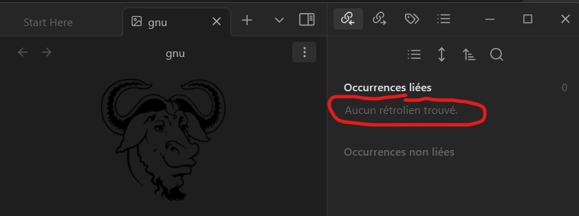

Consider the following Markdown:
\alpha
![[gnu.png]]
where the gnu.png file is this file : heckert_gnu.transp.small.
When I open the png, there is no backlink:

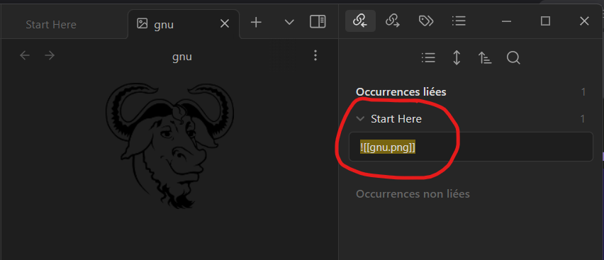

But if the markdown is changed to (notice that the minus sign is on a separate line):
\alpha
![[gnu.png]]
then the backlink appears:
Y. There is no plugin involved. The test was done using the sandbox vault.
When opening the png figure, there should be a backlink to the original markdown file.
There is no backlink.

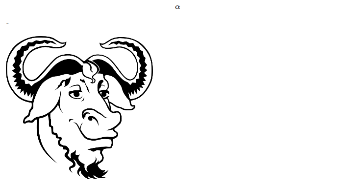

A remark, if you use this syntax in source mode:
\alpha
![[gnu.png]]
The latex formula is not correctly detected, as it can be seen if you switch to preview mode, which renders:
This is the reason why the outgoing link is not “seen” by obsidian.
Apparently, if you want to use $$ as delimiters in a line alone, you cannot include more text in that line (like the dash). That confuses the parser and assumes that those $$ are not math delimiters.
You can instead use $$ in the same line than the formula it delimits. In this case you can have more text in the same line, eg:
$$ \alpha $$      -
![[gnu.png]]
and this works:
And the backlink is detected correctly.
