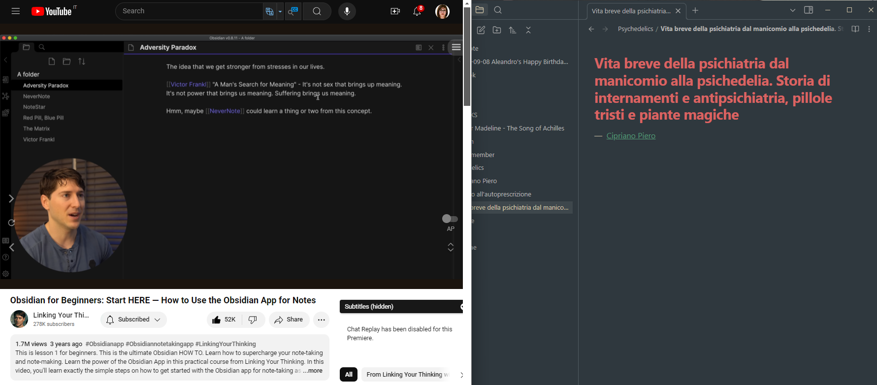

I am new to Obsidian and feeling overwhelmed with the available information. I am trying to replicate a behavior demonstrated by Nick Milo. Specifically, whenever I create a new note, the title of the note is automatically inserted as the TITLE within the note content. My goal is to replicate this behavior while hiding the title inside the note as demonstrated by the author of the video.

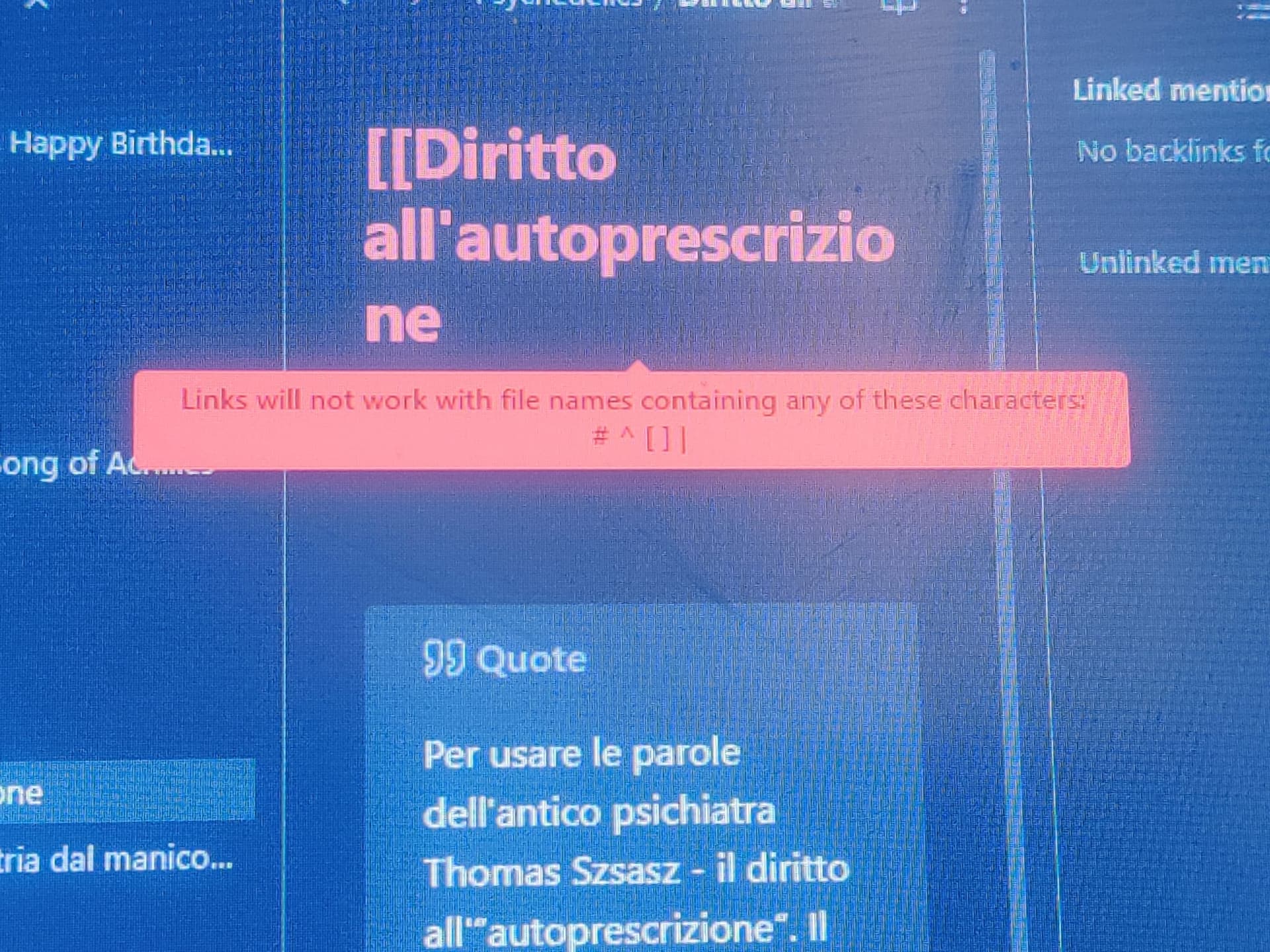

Additionally, I would like the title to act as a link to the note itself, but I am encountering the error:
"Links will not work with file names containing any of these characters: # ^ [ ] / "
Is the title in Nick Milo’s setup a link itself, or am I misunderstanding how this works?

Inline Titles
If you go to Settings > Appearance and scroll down a bit, under Interface you can unselect Show inline title. That removes the title from the note content.

The title of the note is automatically the link to that note as well, or rather you link to it by putting the link between square brackets [[title]]
Without knowing the precise note contents, I’m not sure what the problem with the link from your screenshot is, but maybe you tried adding those two square brackets in the link? That wouldn’t work, so in your case the link should be [[Diritto all'autoprescizione]]. If your note title (or the file name) includes square brackets, that won’t work in Obsidian because it needs the square brackets for the links.
