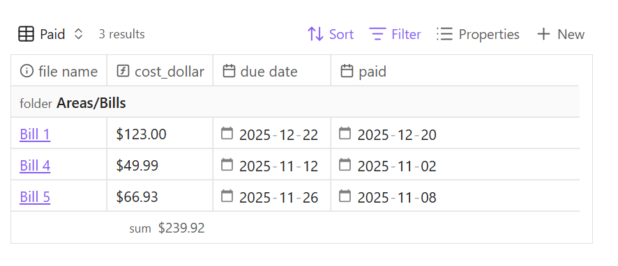

I pasted your YAML into five notes, and both of the Summarize formulas I shared return the correct sum:

A heads up: Your filters in your “Paid” view might have a mistake. You did:

So I kept trying to figure out why you reported this as working but it wasn’t working for me, it’s because you’re on the development version, and I was not.
Anyway, after fixing two lines in the base file, namely:
summaries:
  sum: '"$" + values.map(number(value.replace("$",""))).filter(value.isType("number")).sum().toFixed(2)'
formulas:
  cost_dollar: if(cost, "$" + cost.toFixed(2))
Also, you never mentioned that you changed the cost_dollar formula, which was part of the issue,
AND upgrading to the development version resulted in a solution for me.
Um, that reads to me like you’re blaming me for something? The two lines you said you fixed are the exact lines I gave you in the full base to copy-paste. If you then changed them further to make them work for you, then right on.
But it sounds like with the help of people in this thread, you now have a solution. So that’s good.
