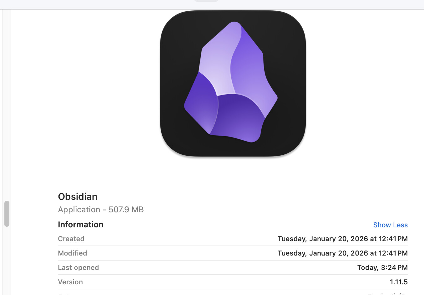

Currently, I have Obsidian 1.11.5 installed (downloaded directly from your site: https://obsidian.md/download). However, Updatest indicates that I should update to 1.11.7.

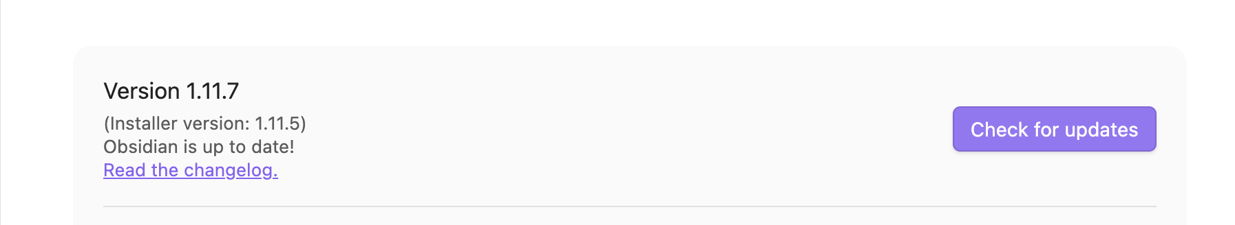

Looking at the app directly in Finder, the version is correctly shown as 1.11.5 (screenshot attached). But inside Obsidian, under About Obsidian, it shows 1.11.7. Clicking Check for updates reports that the app is up to date.

Hello, this is not a bug.
The difference between the app version and the installer version is explained here. The app version has an internal (in-app) update mechanism. The installer version does not (but we do issue a notification if we deem it necessary).
If you wanna use a third-party tool to update the installer, you can do so.
