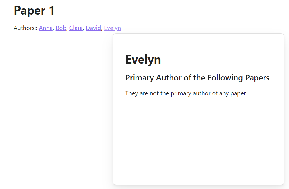

I managed to get something similar, though I dont know how to do the “local graph” part. I hope this will somewhat help, and it needs dataview plugin to work.
You can download the demo vault from the link below to check it out.
When you hover on the link of an Author, you can view its page and have an idea of what paper they contributed.
DemoVault.zip (646.1 KB)
Thanks for the tip of using Dataview.
I’ve tested it a bit, but in the end, I’m really primarily interested in getting this to work in graph, where all the links still show up, so I don’t think this would be the solution.
I’ve tried going the other way around, having the authors only defined as Metadata and then having Dataview automatically create the links, however, it seems that links in a dataview table aren’t included in the list. And even if they were, it would remove the possibility of jumping from a paper to any of the other authors when in that note.
