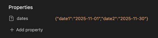

From a quick test in the sandbox vault, this:
dates:
  date1: 2025-11-01
  date2: 2025-11-30
… would return an object under the key dates (which Properties in Live Preview currently doesn’t really support)
If I create a base and display the dates key, I’ll get the same result: it’ll return the “raw” object.

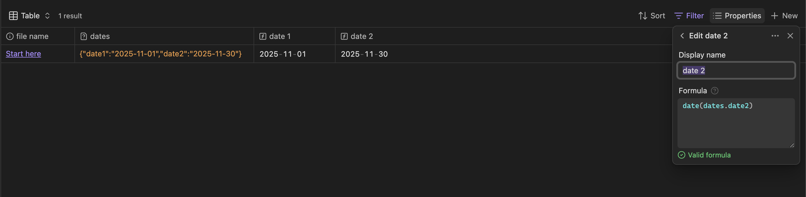

So, to be able to use these values, I would need to dereference them where/when needed … in a formula property (for example) using something like:
date(dates.date2)    // outputs 2025-11-30 (as a date object)
Is this the error you’re seeing ? :thinking:

I wanted to display multiple dates inside the dates property, but I didn’t realize that Obsidian Properties doesn’t fully support this yet and therefore shows them as an “object.”
