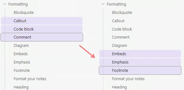

I’m in the sandbox on Obsidian 1.8.9, and with file explorer focused a multi-selection present, pressing Space opens the last-selected file (clearing the selection), and pressing F1 opens some sort of help dialog. If you’re referring to pressing Space+F1 in sequence, to me that seems to open the last-selected file and the help dialog.
Either way, none of these simply clear the current selection, so that different range of files can then be selected. For example, doing this :point_down: requires using the mouse to reset the selection, or requires opening a note with Space and then focusing the file explorer again, AFAIK.
To me, Esc generally means escape from the current context into the parent context if there is one; i.e., Current context = multi-selection within file explorer? Escape to file explorer with no selection. Current = file explorer with no selection? Escape to the “main” content (e.g., a note, canvas, wherever the user was before they focused on file explorer). Current = settings view? Close settings view if there are no unsaved changes/warn about unsaved changes. etc. :person_tipping_hand:
So, if the user is already focused within file explorer and a multi-selection is present, pressing Esc to clear the selection is the most intuitive way to do it, IMO.
