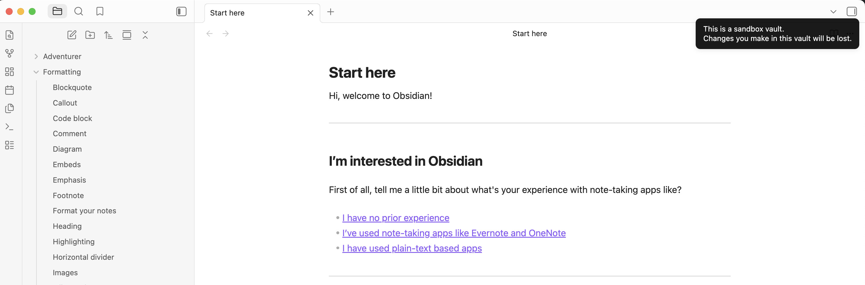

Did you use Obsidian very much? Is there a chance you just opened it to test, and were writing in the Sandbox help vault? It’s an example vault with some tutorial files. Does this screenshot look familiar?
If so, that Sandbox vault gets reset periodically. So if you stored any notes there, they will be gone.
