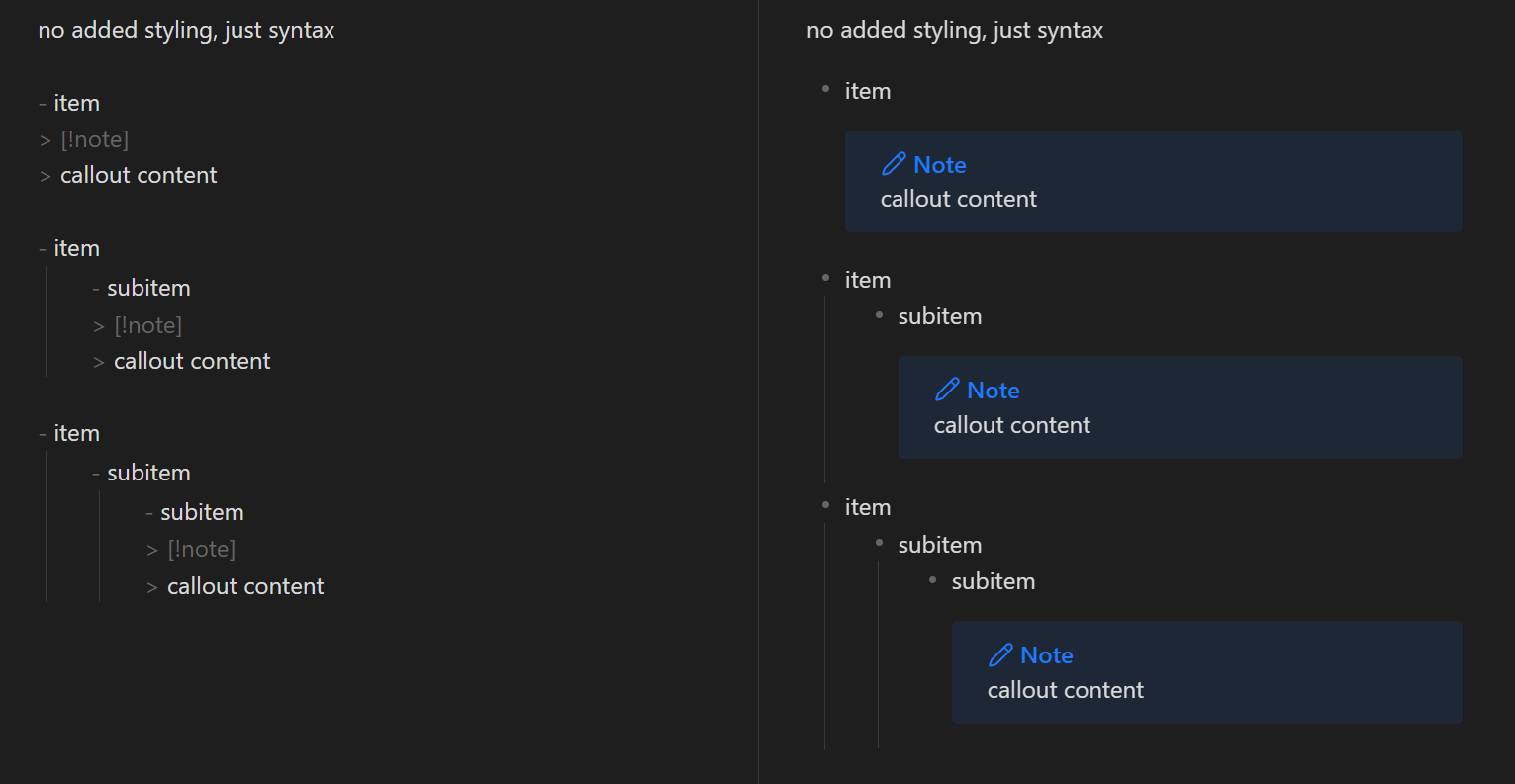

After all that snippeting I feel silly, because you can do it in the rendered markdown. No tricks, just syntax.
Paste this to see how:
- item
> [!note]
> callout content
- item
	- subitem
	> [!note]
	> callout content
- item
	- subitem
		- subitem
		> [!note]
		> callout content
The above gives me this by default:

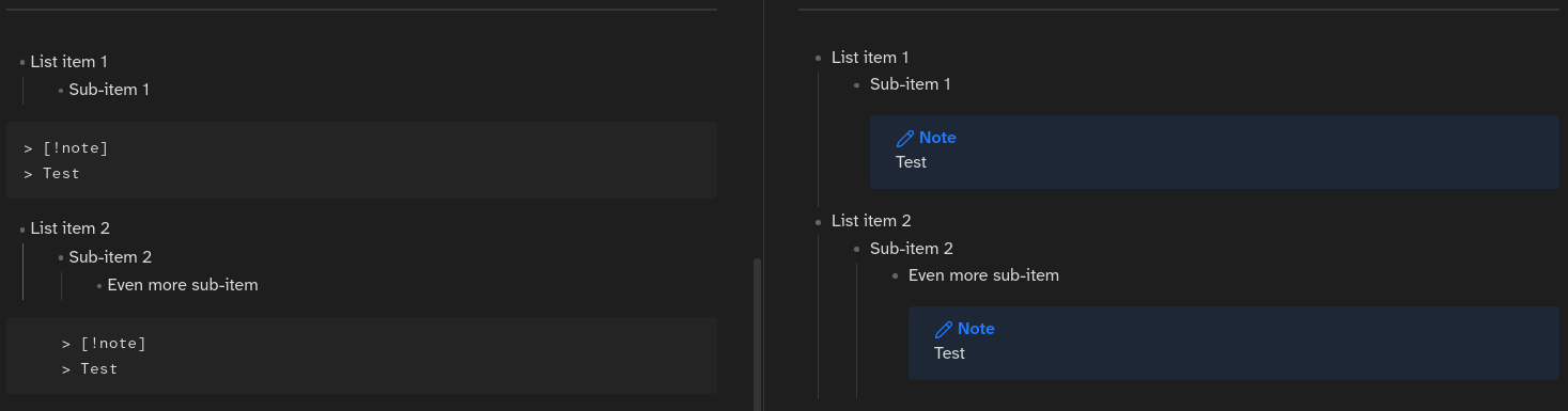

Thanks for your replies. Don’t worry about feeling silly, I’m right up there with you, because I did try exactly what you did but I didn’t check it in Reader Mode.
In the Editor Mode, the callouts aren’t rendered like that when I indent them. They appear as code blocks for some reason.
