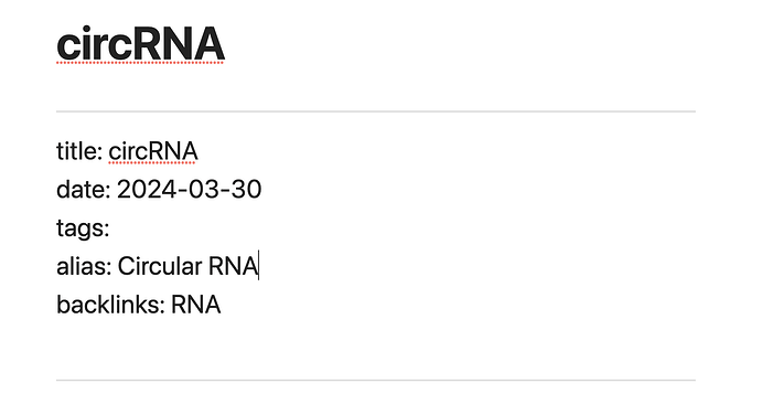

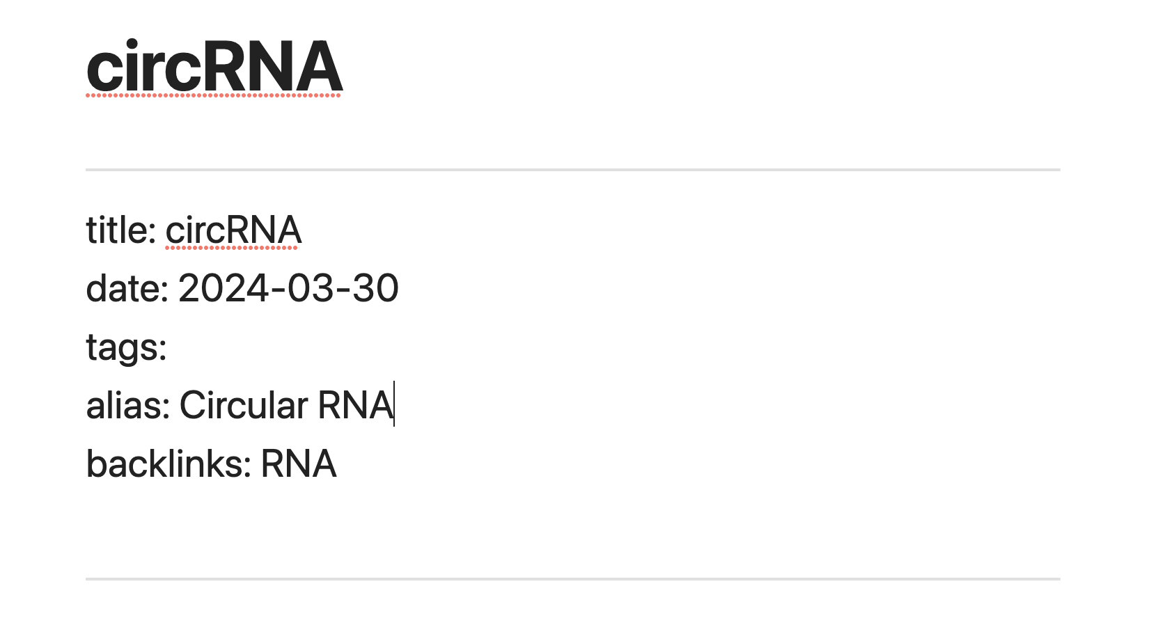

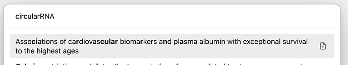

Hi, i am using my templates with YAML and this is my set-up:
I use the alias function a lot, for example here:

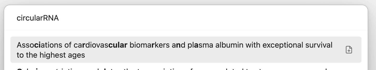

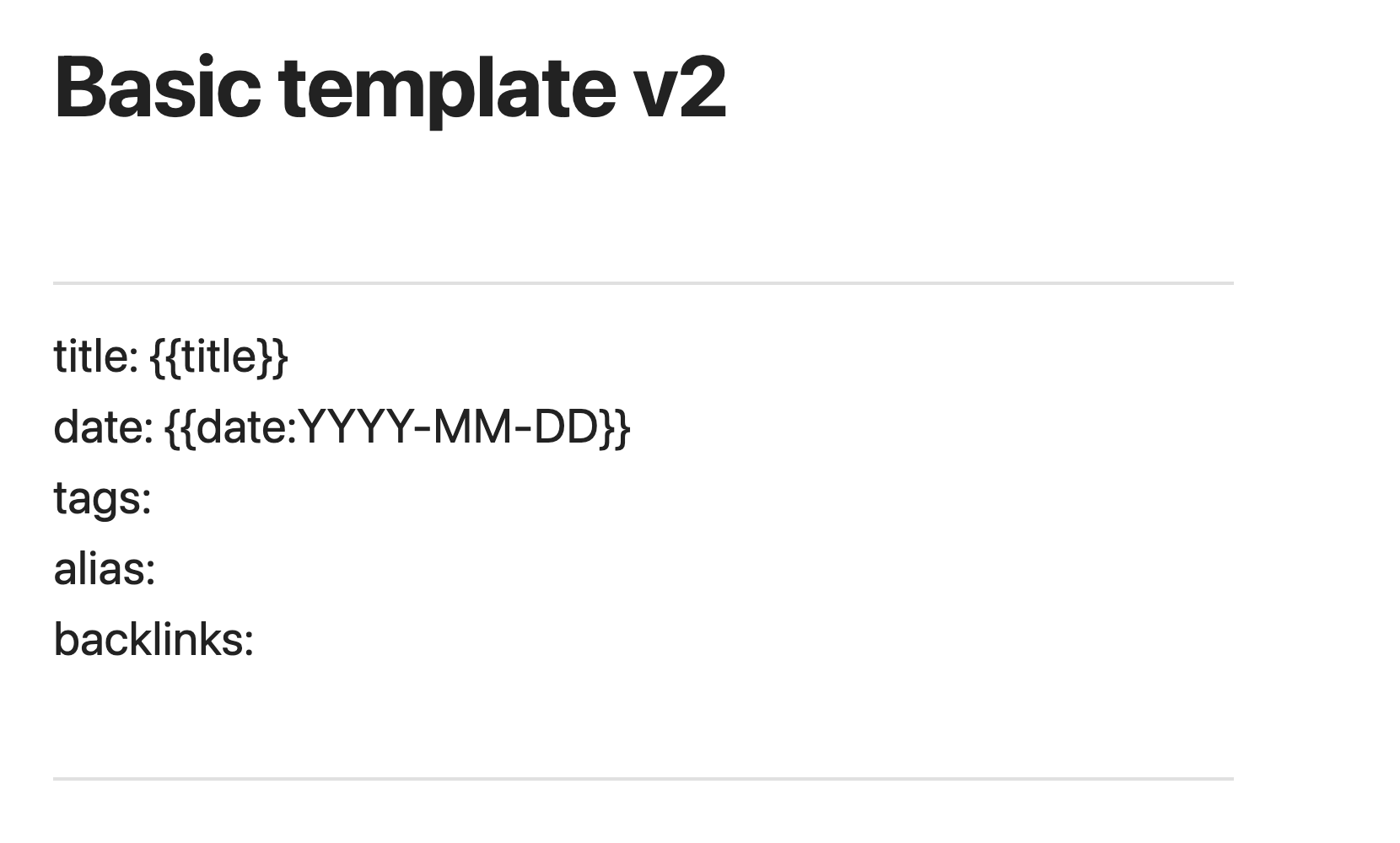

When I try to search for the alias, as example in image 3 - it does not show up?
Seems like my template set-up is not working
I tried replacing alias, with aliases and other notations such as alias: (paragraph) - value1 , (paragraph) - value2
Can someone help?

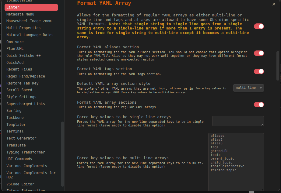

As you can see, the value of my aliases is multi-line, which can be enforced with the Linter community plugin:
  • Never mind the alias2 and 3 there, those were for some temporary workaround and I neglected to delete them.

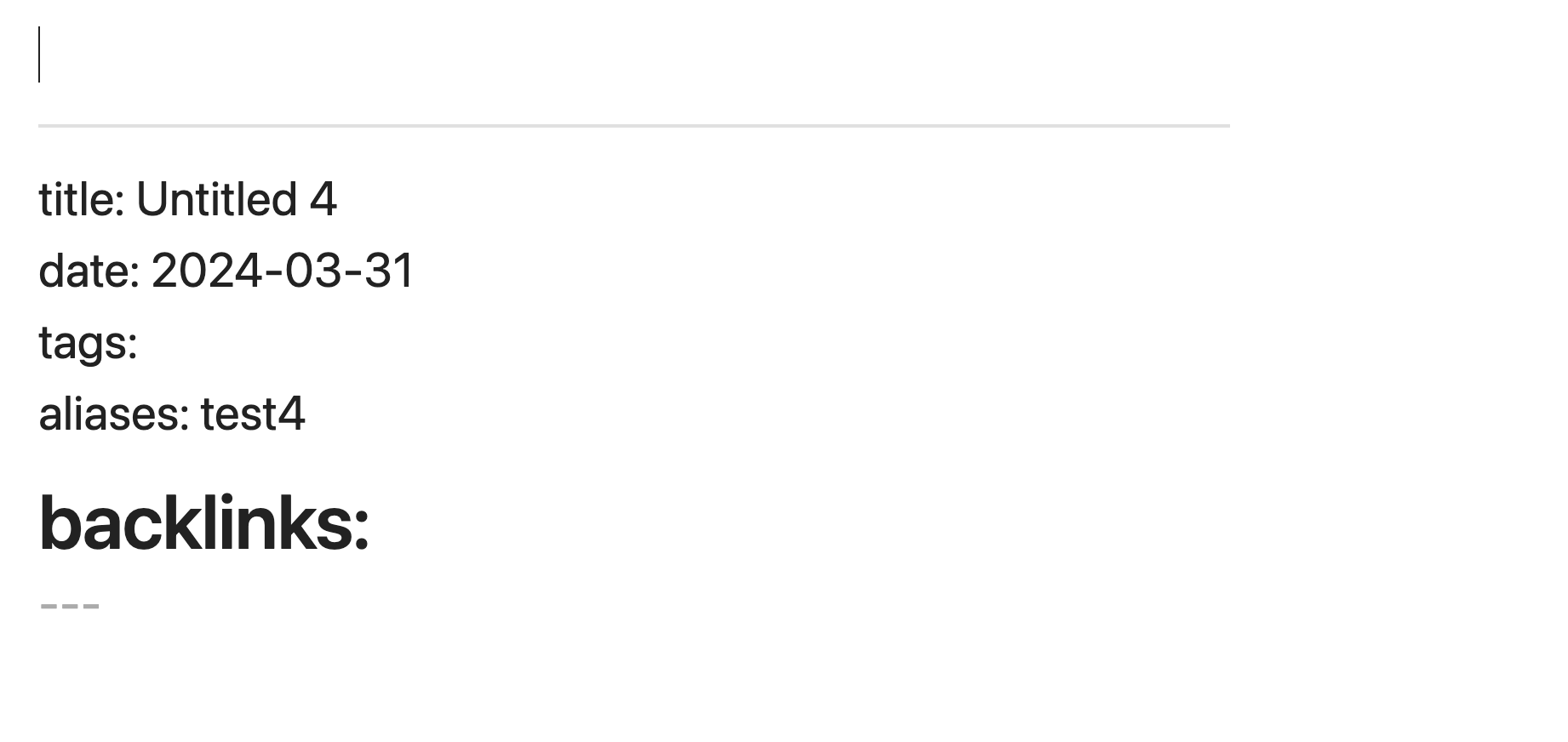

From your screenshots, something doesn’t look right and I actually don’t think your Properties/YAML are in fact, Properties/YAML :thinking: … (it really doesn’t look like it :no_mouth: )
I think you might have an empty line between the very first 3 dashes --- indicating the start of the YAML block in Source Mode… which would prevent the YAML block to be parsed, displayed and used as Properties… (meaning that, for Obsidian, at the moment and if you have indeed a rogue empty line at the top of your template/note, this is just some normal markdown content but not a frontmatter block with keys and values to query…)

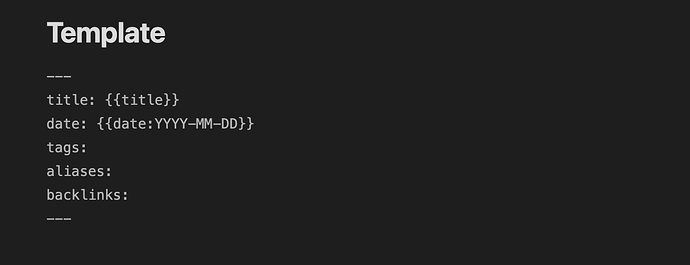

Your template should look like this in Source Mode:
title: {{title}}
date: {{date:YYYY-MM-DD}}
tags:
aliases:
backlinks:
And yes, as Gino mentions, the alias key has been deprecated and an aliases key needs to be used instead :blush:. (See here)
Right, it’s not valid YAML. Otherwise it still should have worked (possibly, not sure whether alias can still be used).
The first three dashes of valid YAML must be on the very first line of the note. Then the YAML keys and values on each line, then three dashes again to close the YAML block.
That’s all there is to it.

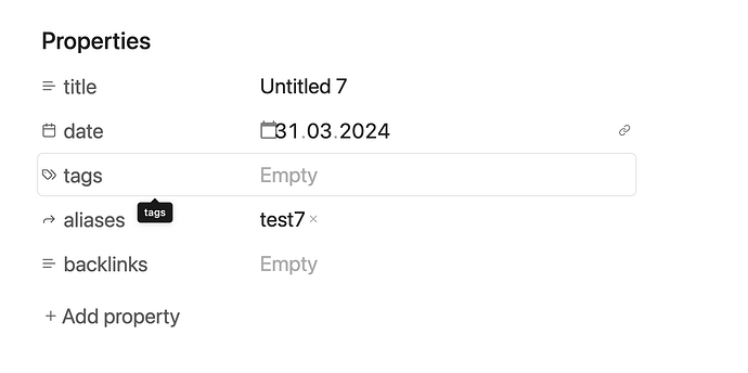

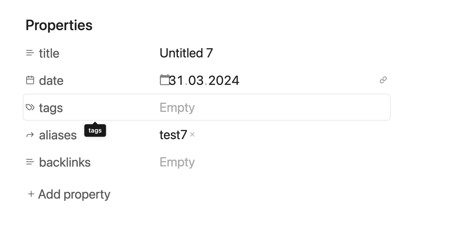

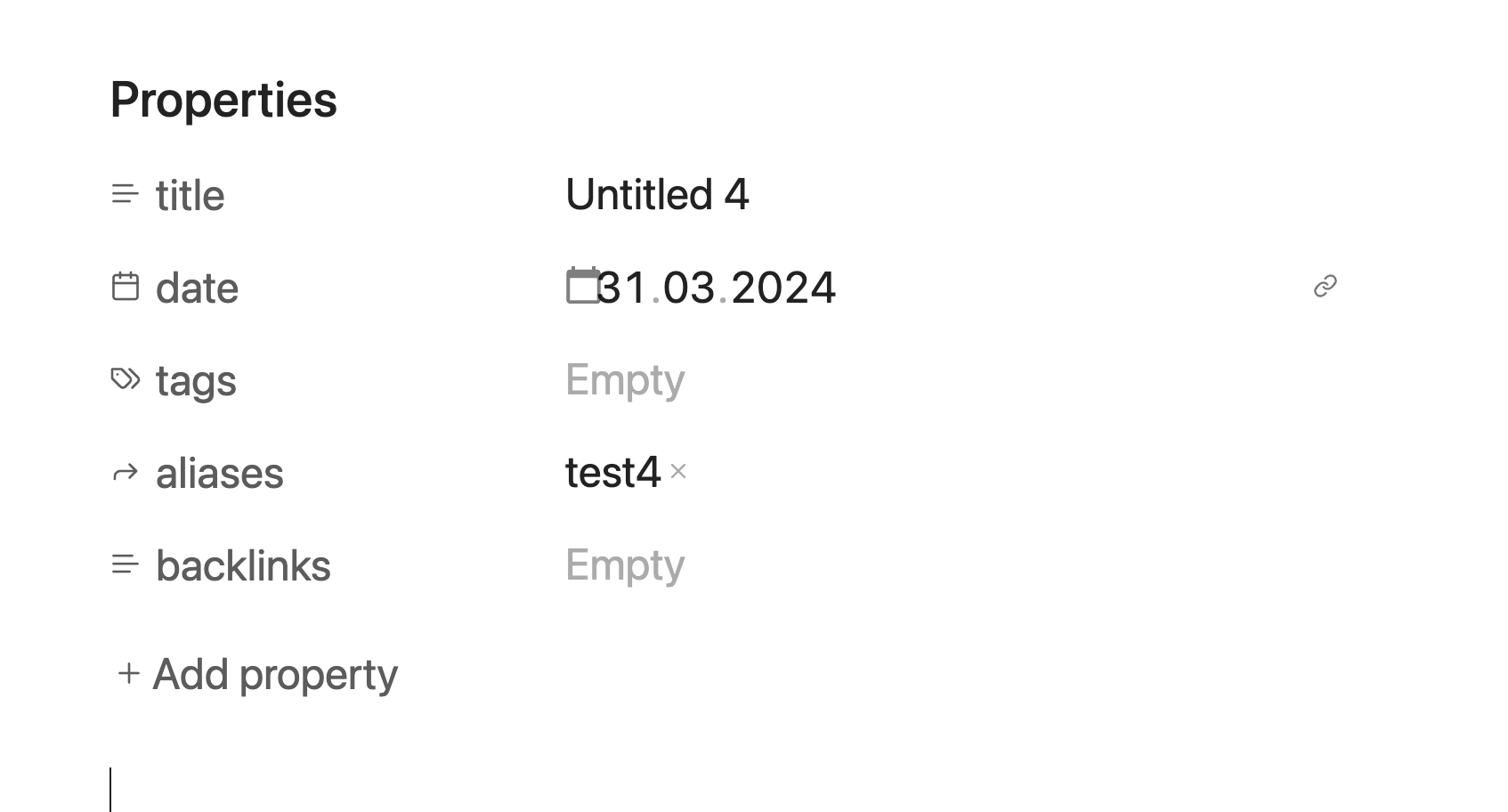

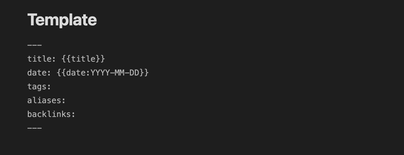

thanks everyone! something is wrong indeed. So i leave one line fr (no other text is there, see screenshot 1), otherwise, it immediately aligned into this “properties” thing (see screenshot 2)
One free line:
Screenshot 2:
Delete the empty line as well above your first ---.
  • Actually, the valid YAML must be in your template so that all files created with it come out correctly formatted.

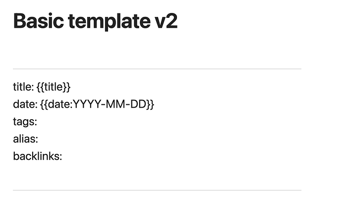

now i have this:
Basic template v2
title: {{title}}
tags:
aliases:
backlinks:
The template name doesn’t need to be added in the file:
title: {{title}}
tags:
aliases:
backlinks:
  • Nothing must come above the first three dashes.
Sorry that is exactly how i had it (the fist line is the header)

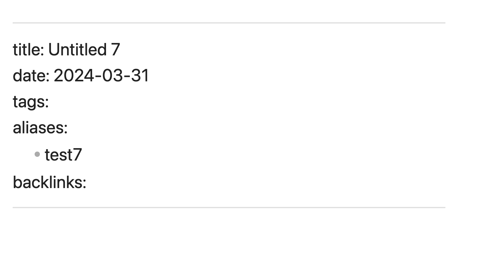

ok so if i have it like this it still does not work :
title: Untitled 7
date: 2024-03-31
tags:
aliases:
	- test7
backlinks:
List items for key values need two whitespaces before the dash, not four.
title: Untitled 7
date: 2024-03-31
tags:
aliases:
  - test7
backlinks:
something is still wrong:
title: Untitled 7
date: 2024-03-31
tags:
aliases:
  - test7
backlinks:
i also keep getting these straight lines:
![grafik|690x393](upload://cLohV8AW6b4zucDTIDCreKT0S3V.png)
Oh, sorry, I see you did generate the file.
The YAML is still not valid.
Is there an empty line above the first three dashes?

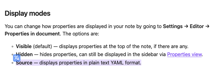

Yes it is! Because if i leave that, it gets formated into “properties” which i don’t like (see screenshot)
ok figured it out! Just need to change the appearance in the editor so its not seen as “properties” but rather in yaml
