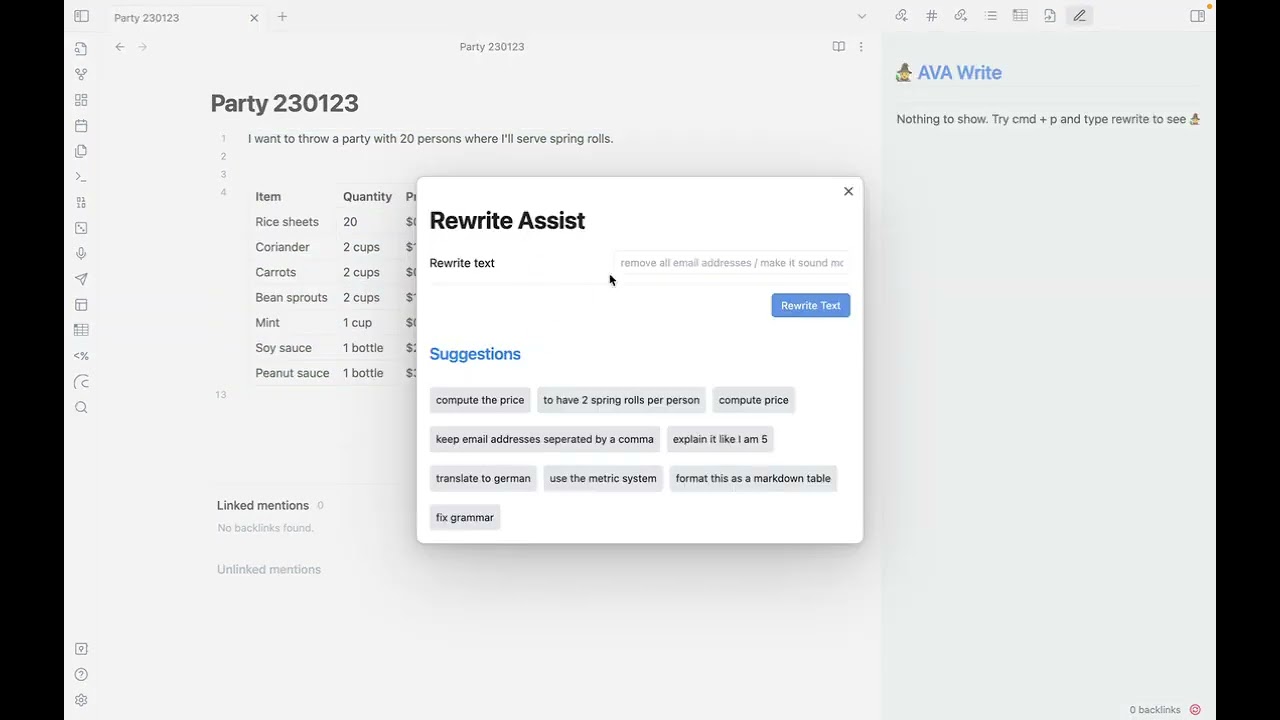

A bit late to the party, but i’ extremely lazy for this kind of stuff. I use advance table everday. But use gpt for the computation.
Using Advanced Table with AVA (perfect for lazy people)
Note: i’m a co-author of ava
