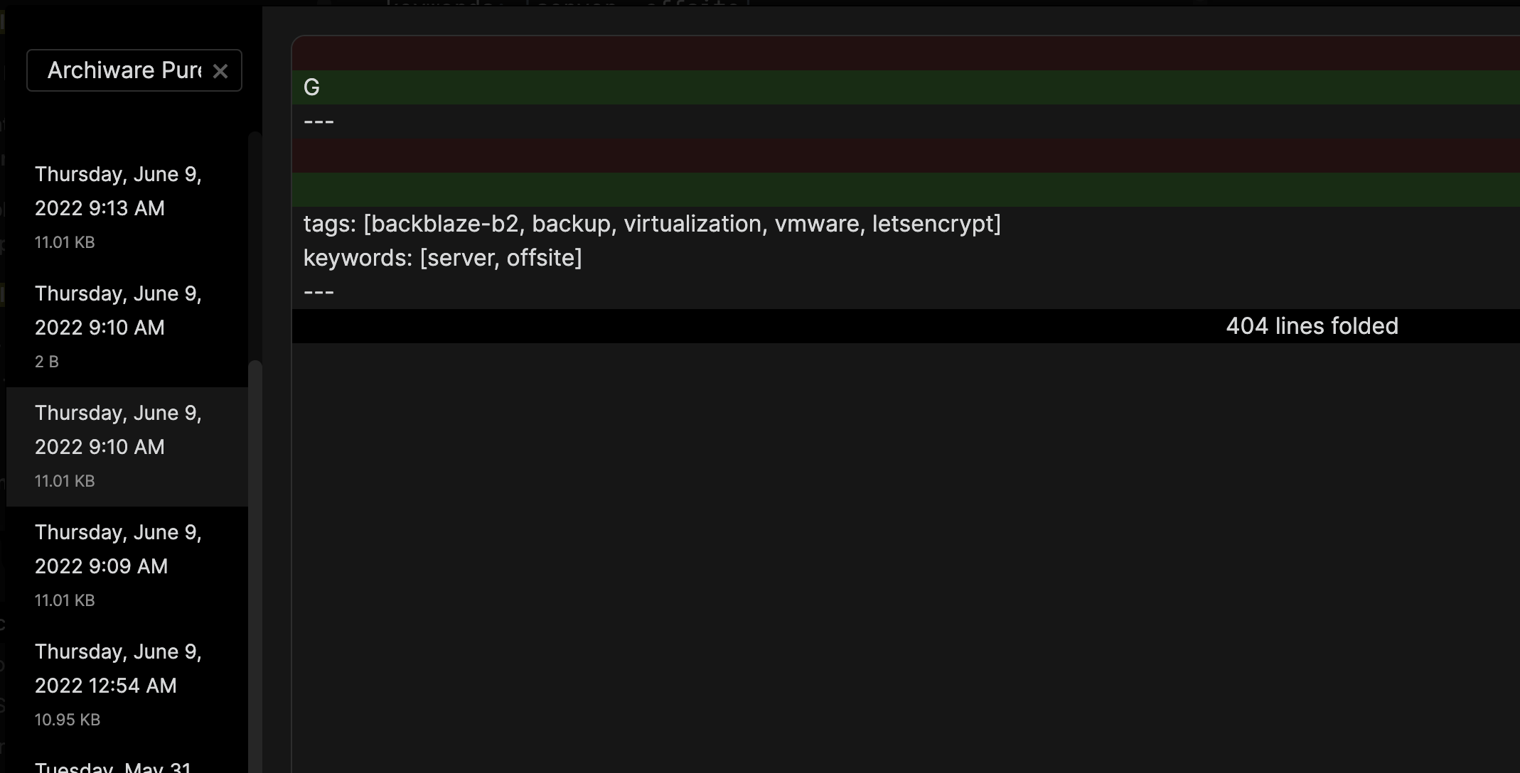

  2. When I switched back to the note that I happened to be on when I pressed ⌘N (filename: “Archiware Pure free backup solution for VMware ESXi.md”) I saw it had been truncated to just the letters Go, screenshot:
  3. When I opened File Recovery to see if I could get the data back, I noticed 2 snapshots of the destroyed note had been created:
    first, this one (11kb) which seems to have all the data, with simply the letter G inserted at position 1, above the YAML frontmatter:
    then this one (2 bytes) which basically deleted all text and replaced it with Go:
    here is this same snapshot scrolled to the bottom
I hope this may be useful to @Licat to provide a clue as to how this could happen? It feels like a race condition.
