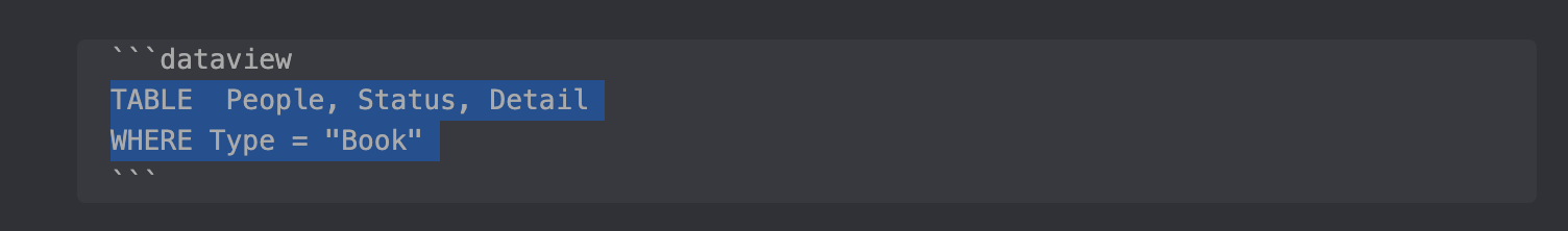

I’ve just started with dataview. I made a table that should pull books with “Book” in the YAML field “Type”, but the table only pulls 3 of the 8 notes is should pull … I will have many more book notes in the vault if I can make this work :). This is my table code:
TABLE People, Status, Detail
WHERE Type = "Book"
I have checked the notes that are not appearing to be sure they have “Book” in that field.
I have searched help and forums to see if the pull is being limited to 3 notes as a default and I need to add a “limit” parameter of “all” or something.

Is the part you posted in your YAML section, or in the main body of the note?

OK, I can see more clearly now. Thanks for posting an example.
Your YAML block has some issues. YAML frontmatter fields are formatted differently than Dataview inline fields.
First, YAML fields should only have one colon. Your “Date_Note” field has two.
Second, links should be enclosed in quotes, e.g. "[[Henry Adams]]" rather than [[Henry Adams]]. This is because brackets have special meaning in YAML, used to define lists.
Third, your Detail field should either be surrounded by quote marks or else have commas between each item, e.g. either:
Can I ask… using Detail: "[[History]]", "[[Philosophy]]", "[[American History]]", "[[@ Dad]]", "[[President]]" reads as invalid YAML. The values do work if arranged as a sequence. Or am I doing something wrong?
Thank you so much for your attention with this. Putting quotes around the bracket links cleared up the problem with how that content displayed in the table. I revised that situation across all the books and removed the second colon in the Date_Note field. This made one more book appear in the table, but still not the other few. For instance this:
