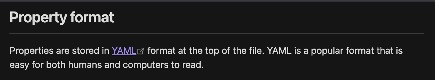

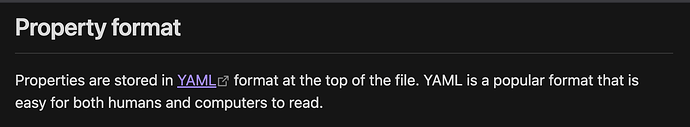

I noticed that when I use “Tags” (capitalized) as a property name, the tag values display without purple highlighting (screenshot 1). But when I use “tags” (lowercase), all tag values show with proper purple highlighting (screenshot 2).
Is this intentional behavior? Which format is correct? (I assume lowercase “tags” is standard.) Why does Obsidian allow capitalized “Tags” as a property name if it breaks tag highlighting? Also, why does only “tags”/“Tags” trigger this behavior (other words like “eags” or “eggs” don’t work as tag properties)?
