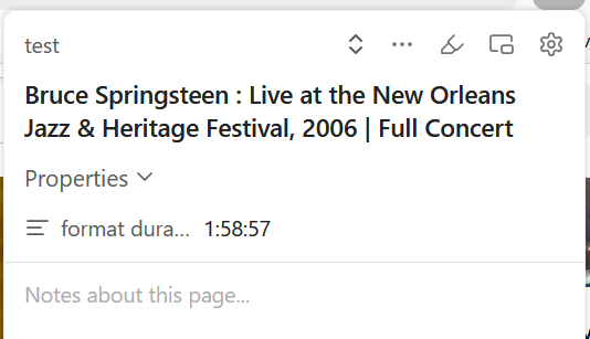

Keep the “S” in there so the duration function knows what your units are:
{{schema:@VideoObject:duration|replace:"PT":""|duration:H:mm:ss}}
The Boss example:

The syntax from my last comment is how you enter it into the extension interface shown in the image right below it.
Still, the point is: Just remove the part that replaces the “s”.

Update: To stay as close as possible to what you showed in your original post, I didn’t put quotation marks around the tokens, and it works for the output in question. But the docs use quotation marks—I assume to account for other token and literal combos that would need it—so here’s a version with quotation marks:
In the JSON:
			"value": "{{schema:@VideoObject:duration|replace:\\\"PT\\\":\\\"\\\"|duration:\\\"H:mm:ss\\\"}}",
In the interface:
{{schema:@VideoObject:duration|replace:"PT":""|duration:"H:mm:ss"}}
Thanks again dawni, all is working fine now. Good starting point for optimization of this template to my own needs now. And for further learning as well.
