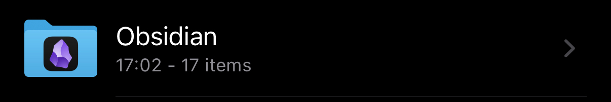

I don’t know how Syncthing works but I can tell you that there’s no way around the dedicated Obsidian folder :innocent:
Obsidian can only access, on iPhone/iPad, what’s under its dedicated folder, whether you use iCloud Drive to store and sync your vault(s) across devices or locally, “On My iPhone/iPad”.
This is the place where vault(s) should live :blush: .
Wouldn’t there be a setting somewhere, within Synctrain, to sync the content of your vault to and from the Obsidian folder ? :woman_shrugging:
I mean, some out here, seems to have had some success using Syncthing and Mobius Sync (on iPhone/iPad) to sync their vaults across devices… so I don’t see why that wouldn’t be feasible using Synctrain instead :woman_shrugging: (but I just could be wrong :innocent: )
