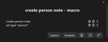

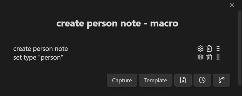

Been wanting to try QuickAdd and gave it a go for this. So:
  1. Click New choice and select Macro
  2. Click Template and, for the path, enter the path to your person template.
    • Set the rest as you please. Then click Done.
  3. Click Capture and set these:
    • Location > Capture to active file: enable
    • Position > Write position: Property
      • Property: Named property
      • [enter the name of your property, e.g.,] type
      • Action: Set value
    • Content > Capture format: enable
      • [enter the value that will replace template in your new note, e.g.] person
  4. Optionally, in the macro window:
  5. Click Done.
Go run your new macro.
