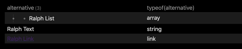

```dataview
TABLE WITHOUT ID
 alternative, typeof(alternative)
WHERE file = this.file
FLATTEN alternatives as alternative
You should get an output resembling:
Your original definition of a “link” is actually an array of arrays, or a list of lists, which in the table is shown as the double bullet, and the typeof array. If you look in the outlinks pane for this document, you’ll also see that only the “Ralph Link” is an actual link.
In other words, a link in the properties/frontmatter needs to be written as ""[[Your link]]"
