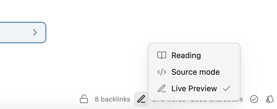

In Obsidian there are three editor views/modes:
  • editing (Source mode) → you see the raw markdown
  • editing (Live Preview mode) → a hybrid view that tries to give you a WYSIWYG experience by hiding Markdown if your cursor isn’t over it; this the default editing view
  • reading (Reading view) → the rendered HTML

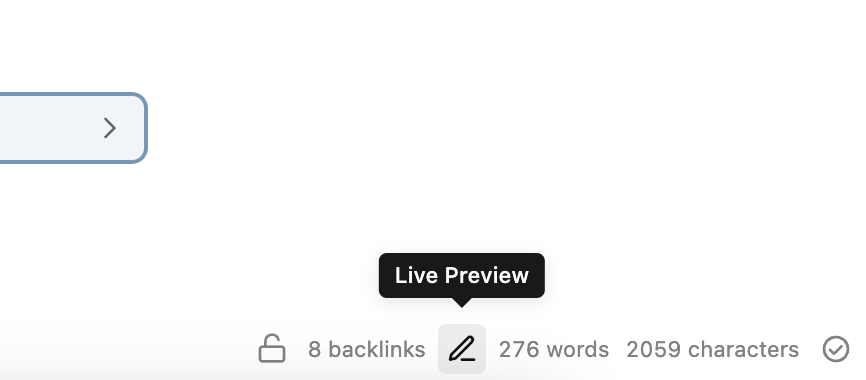

If Settings → Editor → Editor status is toggled ON, you’ll see this at the lower right of your Obsidian window, and you can change views here:
No matter where you cursor is, if you switch to Source mode, are your links still there?

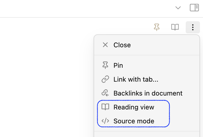

You can also change views from the three dots menu in notes:
