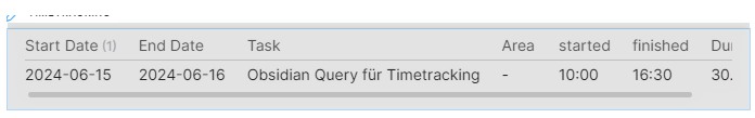

This:
[!tldr+] Timetracking
	TABLE without id
		dateformat(date,"yyyy-MM-dd") as "Start Date",
		dateformat(myEndDate, "yyyy-MM-dd") 	as "End Date",
		title AS "Task",
		folder AS "Area",
		startTime AS "started",
		endTime AS "finished",
		dur( date(dateformat(myEndDate, "yyyy-MM-dd") +"T" + endTime) - date(dateformat(date,"yyyy-MM-dd")+"T"+ startTime)).hours
		 as "Duration"
	From "00_Timeline/Personal"
	WHERE contains(dateformat(date, "yy-MM-dd"), "24-06-15")
	FLATTEN choice(!endDate, date, endDate) as myEndDate
	sort date ASC, startTime
outputs that without endDate:
and this is frontmatter contains endDate:
