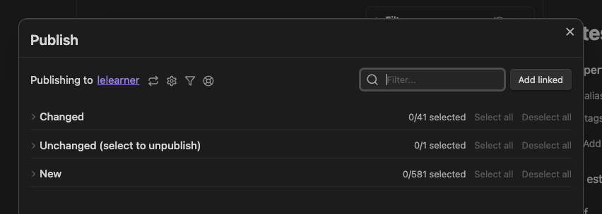

I noticed I have some folders remaining in my published version despite having deleted them in the Vault. I’d like to get rid of them in my published version
I’ve tried to unpublished everything (expected my home page) and the folders are still appearing in my publish version
Here’s below the current state of my publish version. As you can see we can see folders.
As you can see below, everything but one file (my home page) is unpublished.
Does anyone have a fix ? :face_with_monocle:
Thanks !

Hello, as I said I’ve unpublished everything using the “publish UI” but that doesn’t change my published website.
if you had unpublished everything, there would nothing on your website and the there would be no “changed” section in your screenshot. Again deleting files locally in your vault does not mean you unpublish things.
Then how do you explain that I have only one file in "Unchanged (select to unpublish) and still many files published on my website ?
(the one file remaining is my homepage which I didn’t unpublish)
As you can see in the screenshot of my first message, the Change section contains only one file, yet on my website we can see many files.
Thanks !
no, in your screenshot, the Changed sections contains 41 files (of which 0 currently selected). It means that 41 published files are currently different from the local version on your computer.

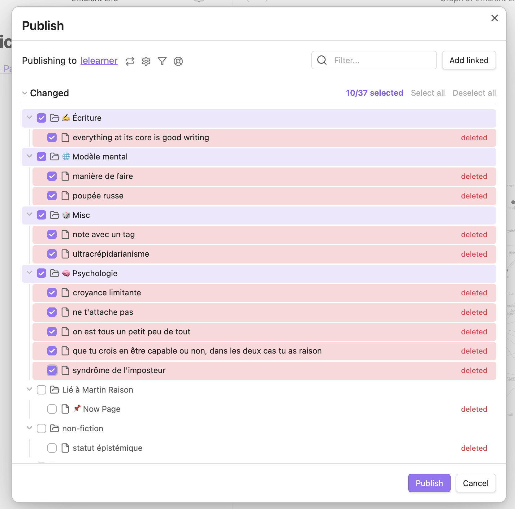

What I had to do was to select the deleted files in “changed” and hit publish.
My confusion came from the fact that I had to click onto the buton “publish” to unpublish them which doesn’t really makes sens does it ? :face_with_monocle: :smile:
