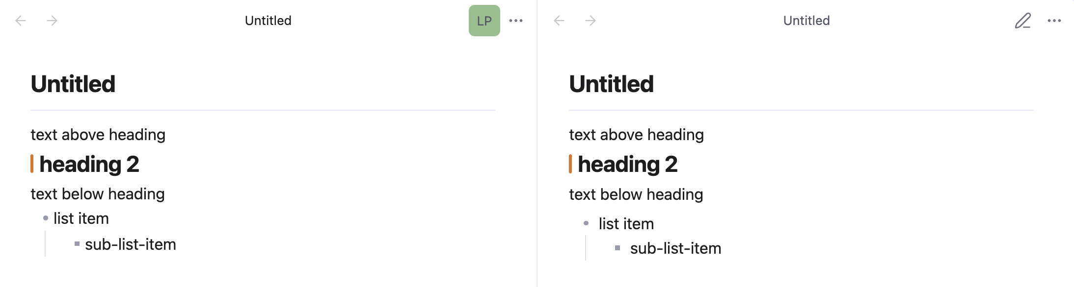

For example here:
.mod-cm6 .cm-editor .HyperMD-header, .markdown-reading-view .markdown-preview-section :is(ol,ul) {
    margin-bottom: 0;
    margin-top: -0.8em;
.mod-cm6 .cm-editor .HyperMD-header is for headings in the editor and they are getting a margin-bottom of 0 and a negative margin-top of -0.8em.
I would try adjusting these variables to start and see if you can get things looking alright.
  • --p-spacing defines the spacing between paragraphs (defaults to 1rem).
  • --heading-spacing defines the spacing above a heading when it follows a paragraph (defaults to 2.5x paragraph spacing).
For example; adjust values as desired →
body {
  --p-spacing: 0.3rem; /* default -> 1rem; */
  --heading-spacing: 0; /* default -> calc(var(--p-spacing) * 2.5); */
  --line-height-normal: 1.5; /* default -> 1.5 */
/* if needed */
/* heading top+bottom padding in the editor */
.markdown-source-view.mod-cm6 .HyperMD-header {
  padding-block: 0.2em; /* padding-block is combined padding-top+padding-bottom */
live preview | reading view

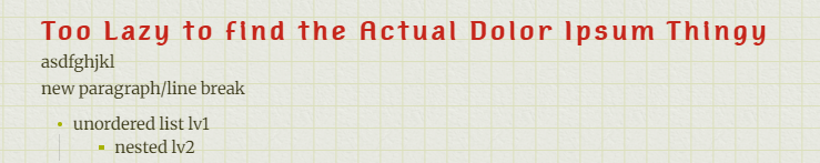

I’m specifically looking for a way to make the Reading view have similar spacing and line breaks as Source view:
I’ve managed to get this going on:
By changing the previously shown margin-change code except I removed all .mod-cm6 .cm-editor .HyperMD-header, so the changes should be only implemented in Reading view. There is less spacing between headers and body text (which is good), but the paragraph spacing/line break is completely lost (unlike in Source view). Both &nbsp;and <br> create waaay too big spacing in the Reading view, plus they’d be annoying to have to type.
Basically is there any type of code that will translate the way the text appears in Source to how it appears in Reading?? With the same spacing, line height, line breaks, and so on?
