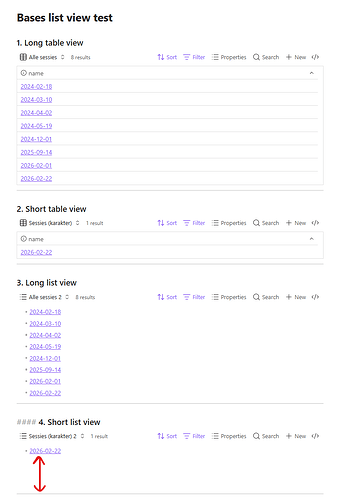

I’m trying to embed a base in a note as a list. I use a filter based on this.fileto filter the base for all entry’s that have a link to the current file in a certain property. This works fine, but rendering short lists generates some unexpected whitespace below the list. This whitespace is not present in other views (e.g. table view). See image below.

I’ve tested this with filtered lists of different lengths, and it seems the list + whitespace stays a consistent length until the list is 5 items long, from 6 items on the whitespace is gone and the list grows as normal.
Is there a way to make short embedded bases in list view show up without this whitespace?
