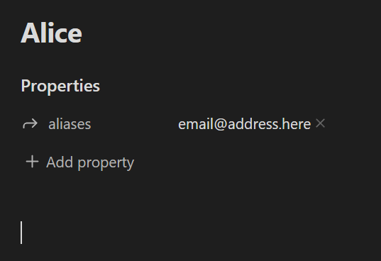

The way aliases work is that once you’ve added the email address as an alias:

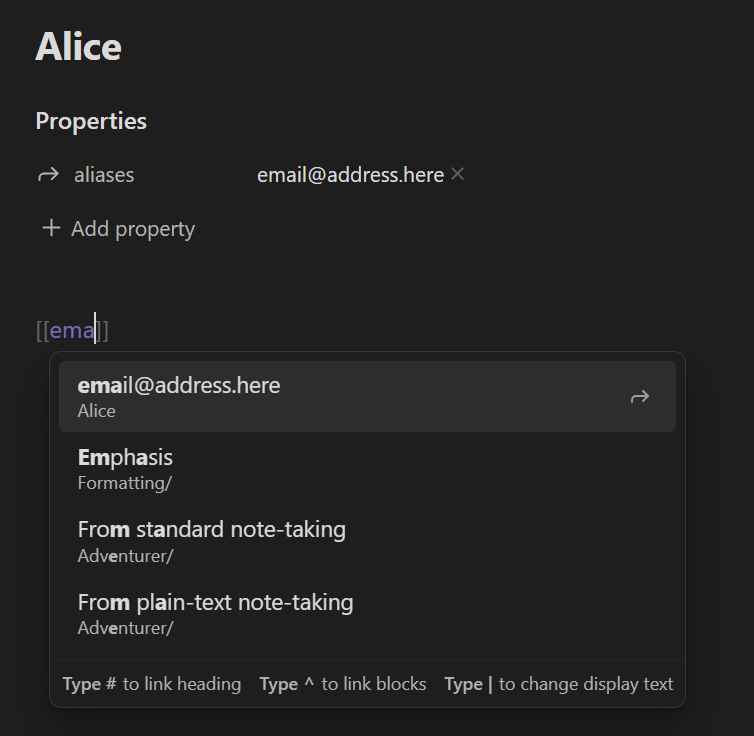

you can start typing a link to the alias (not to the note’s name) then select it from the suggester:

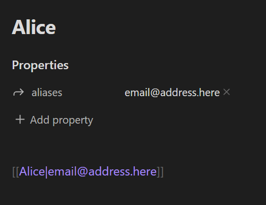

which inserts a link to the note with the alias as display text:

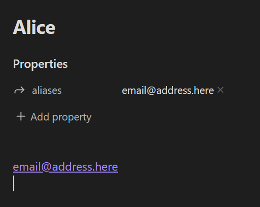

rendering the email address as a clickable link to the note:
