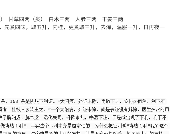

我从别的地方复制过来的文字无法修改格式
如图,上方的文字可以正常修改,下方的文字我无法加粗或者修改颜色。

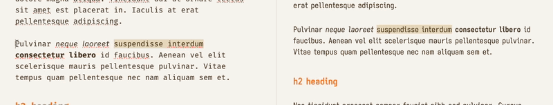

It looks like the text at the bottom is indented (a tab or four or more spaces), marking it as a code block. Bold, italics, links, etc., won’t render in a code block.
Live Preview | Reading view
