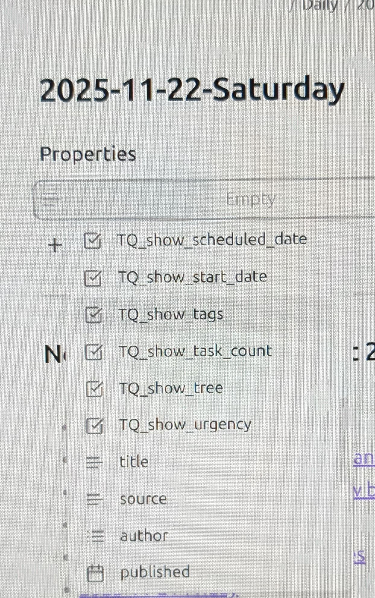

The drop-down menu for adding file properties has unwanted, unrecognized entries

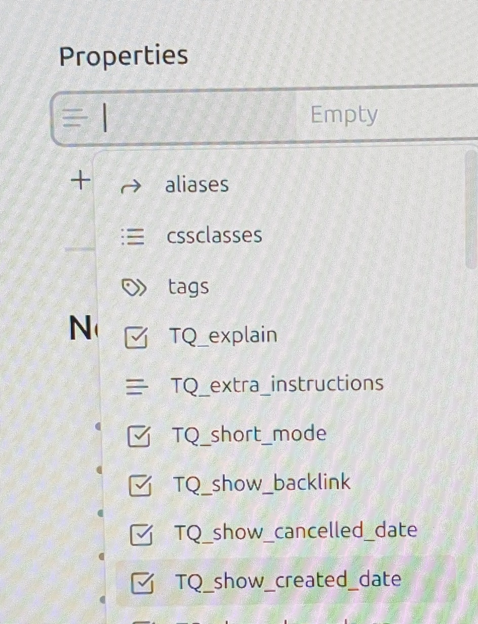

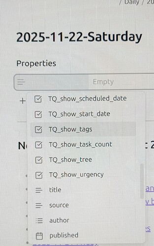

In any note, when I go to “add file property,” and the drop-down menu appears, there are numerous items that start with “TQ_”. For example, TQ_explain, TQ_extra_instructions, TQ_short_mode, and others (see attached screen shots).
I’m trying to eliminate these TQ_ things from the drop-down menu.
I’ve searched all my notes for these file properties. I found only one note with one of the properties. I deleted the that property from that note.
In this forum, I searched for “tq” There were several results. I read all of them and none of them concerned file properties starting with TQ.
Chatgpt was totally unhelpful.
